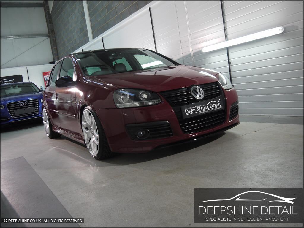

Finally got the TD 1.3 wheels fitted today. Went with Goodyear Asy3's in the end. Fantastic grip.
Waited months for these to be made to the correct centre bores and gloss black finish.
Nice people at Rimstock if you speak to the right person.
Bilstein B16 being fitted Friday so going to take another 15mm out the ride height.
Really pleased with these and cant wait to get the Brembo BBK on.

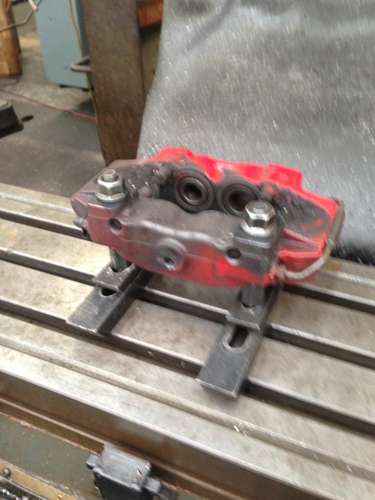

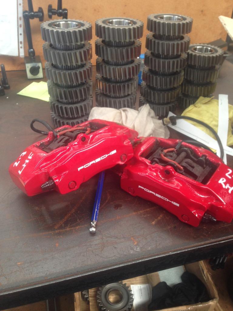

Installed my NQSBBK along with new rotors and pads all round.

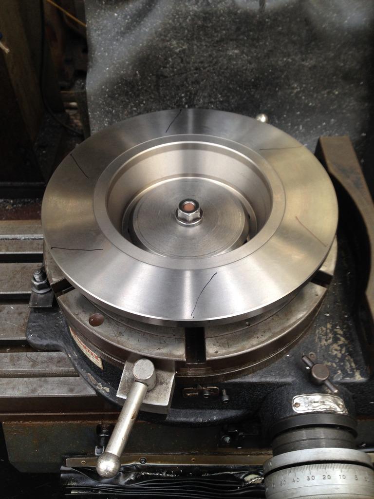

Went with plain Brembo rotors which I slotted myself. Got the calipers from Steve Strange Wreckers in U.K. which seemed to be the cheapest place. I chose these ones as a previous owner had already painted them red, albeit a poor job. They look ok on the outside that you can see once on the car and my car is hardly pristine so I just left them as they were.
Mounted them with the Vagbremtechnic adaptors and lines.
For pads I got Ferodo DS2500 as many people on here rate them highly plus they are available as a modified Boxster S pad that sweeps the whole 312mm rotor.
Although the calipers looked rather shabby, after complete disassembly I found that all seals and dust boots were good. I glad we don't salt the roads here in New Zealand as these were covered in it.
The pad retaining pins wouldn't even budge initially so after soaking with penetrating spray I got them out and used a media blaster to clean them and the pad springs.
Used the mill to take a mm off each of the posts.

Nice bunch of gears there!
Is the pad supposed to hang out of the caliper like that?
Offline The Red Warrior
  • Posts: 279
« Reply #10400 on: April 25, 2017, 01:56:33 pm »
Yes, it's actually a pad originally for the Boxster S that Addition Motorsport have machined to fit the standard Boxster caliper so that it sweeps over the whole rotor. The standard Boxster ones leave a small unswept area at the bottom which goes a bit rusty.
Those gears are actually for a Nissan R35.

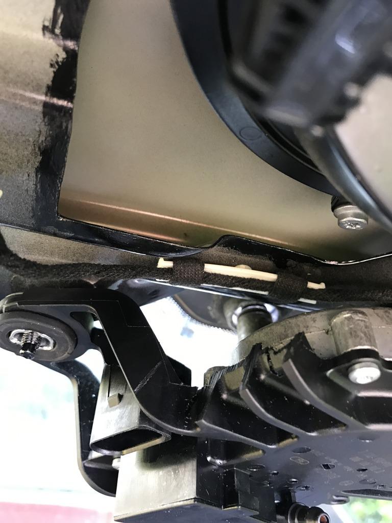

Went to sort my leaking rear washer today and discovered some previous owner hackings.
The dimwit cut a section of metal away and also cut a support arm off the wiper motor assembly  :congrats:
This precisely why people steer clear of modified cars.  I now need to buy a new motor and weld a studded piece of metal back on to support the motor.
Has anyone got a picture of what that area is supposed to look like as standard please?

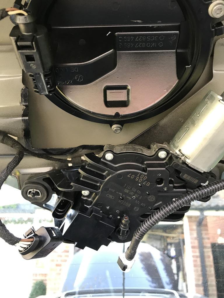

Sorted this piece of mindless vandalism.
Had to buy another motor @ £140 and welded an M6 bolt to a piece of 0.6mm plate.  I was going to weld it on, but decided to rivet it instead in case the next owner wants to fit a camera, coz I'm nice like that.
What's the big deal I hear you say? Well, I observed the motor's behavior with the tailgate panel removed and it moves around a lot when only held down with 2 bolts.  So much so, it wore out this rubber grommet, allowing water through and into the car, so I had to replace that as well.   It's all tight and secure now, as VW intended.
I'm all for OEM+ upgrades, but not when it involves chopping the car up.  My OCD can't handle it!!
