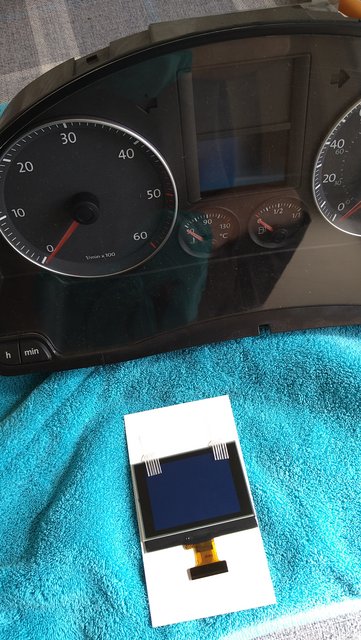

clocks display fade fading
« Reply #12479 on: August 24, 2022, 03:21:52 pm »
LCD display fading has been getting worse Seems to be the hot weather :thinking: Anyway I bought a replacement display from HK
Had it fitted within 1/2 hr  straighforward as long as you dont scratch or snap any fastenings :happy2:
