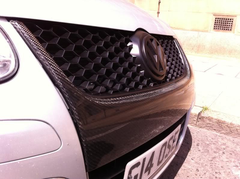

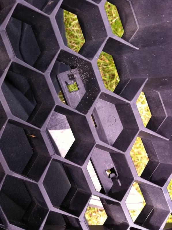

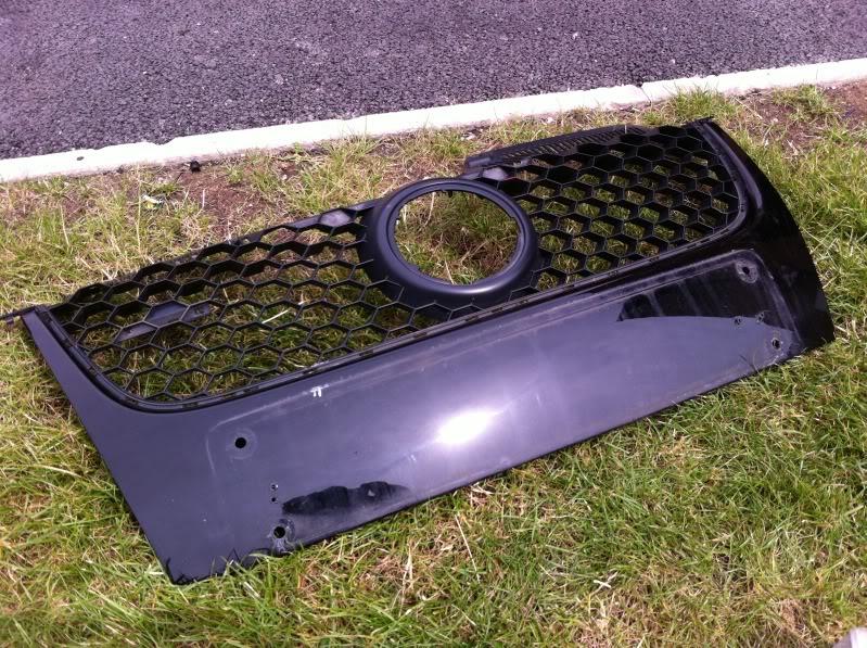

Anywho Update. Modding Me Style, its like Art Attack,
Take on Genuine GTi Grill....
Remove Red stripe strip, number plate surround and un-needed badges....
Then notice, that the chaps at Wolfsburg have left some horrible clip plastic bits for the badge to attach
Use your aerospace diamond tipped rotary cutter to remove the un-needed plastic crud for an OEM+ Look (saves weight dont you know  :P  :D )
Add a lashing of ginger beer...whoops i mean satin black paint, spray red strip satin black also, satin black brand new grill badge and then bond ones Carbon Fibre front grill surround and achieve this....
Excuse the Poop iPhone pics, SLR pics coming soon, along with a chassis notch and split black headlights :)

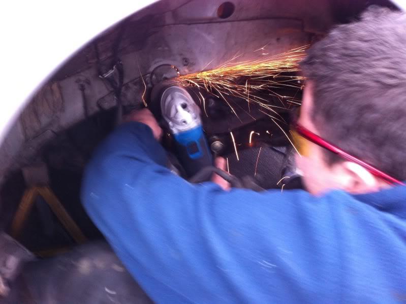

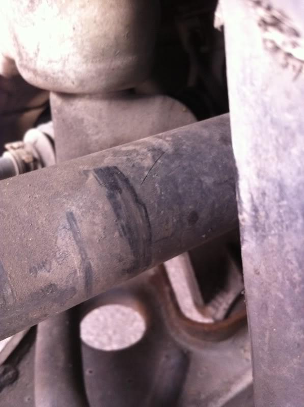

Mad Mike Houghton the king of notches in Hull dropped me a text last night giving the go ahead to do the chassis notch and remove the helper springs on the Jetta. Stripped the car down last night which proved a nightmare. Had to remove the lower arm in the end just to gain enough room to get the shocks themselves out after seperating them via impact wrench and stripping it all down.
Good Job we did it though, looks like it was starting to rub.
Picture in action before the camera died.
But all in all, I now have a chassis notch :) So Im happy, now I can go silly low without worrying, only slightly negative is I think I caught an ABS sensor whilst put the struts back together, so ive got the ESP, ABS and Sateering light on :( think I best plug VAG COM in :)

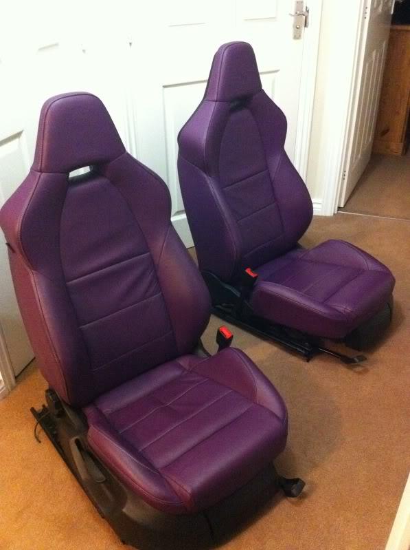

Seat Leon Cupra K1 Seats in Plum Weir Bridge Leather. Bought them off a top lad called Tom Gilvert based in Leicester. His family were really nice and welcoming and very hospitable. Cna thank them enough and good luck to them in their Worx Saxo testing today.
It comes as a full interior, just making some modifications to the rears then hopefully full interior should be in by next week :) Love the Colour :) Ill bang some proper pictures up tonight, i was knackered form 2 late nights on the car so only had an iPhone pic :)

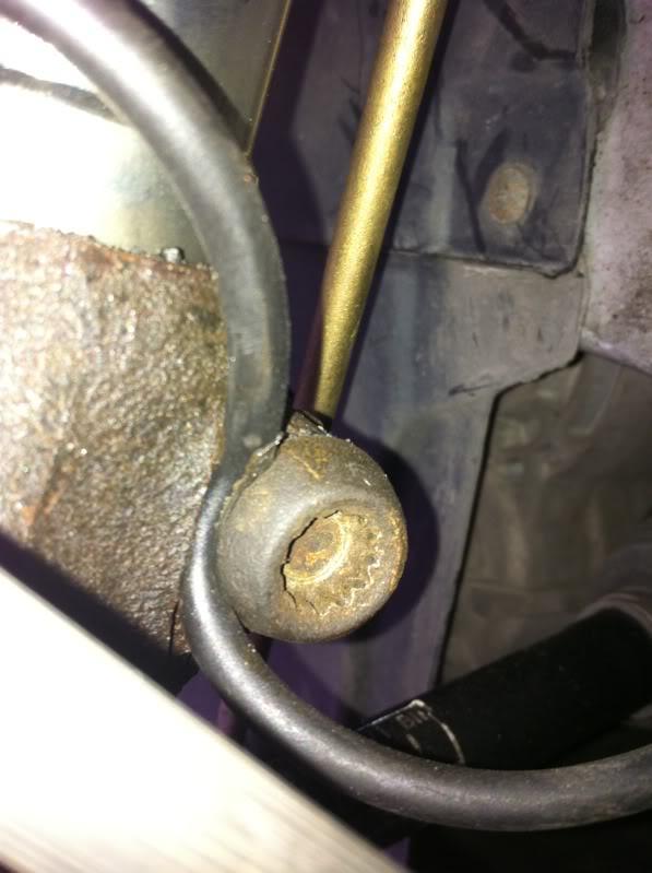

After bolting the car back together, started having a christmas tree effect on my dashboard. ABS, ESP and Steering light on. Emergency and alarm bells starting thinking oh poop.
So anywho, needed to put the arch liners back in and adjust the ride height so thought id investigate. After readjusting the height of the coilies I started having a gander around checking every bolt was nipped up as it was 1:30AM on Wednesday morning last week so I was knackered.
Then stumbled across the culpret and then what it looked like unbolted.
Destroyed just the yellow wire, but thought I might aswell re-solder and wire them back again, I also gave  alittle extra length to allow for a bit more movement as the wires were a little short. Turned over this morning and sorted after a few miles when the ABS cleared its head.

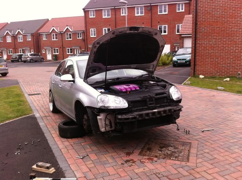

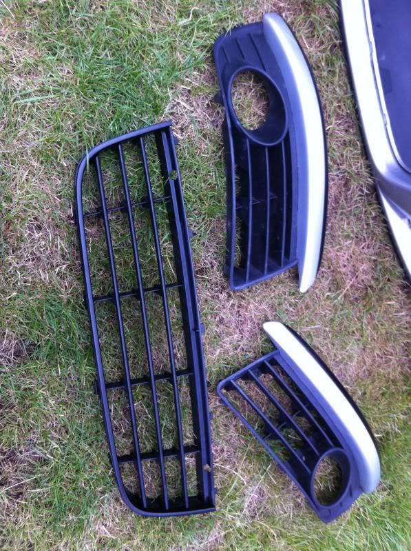

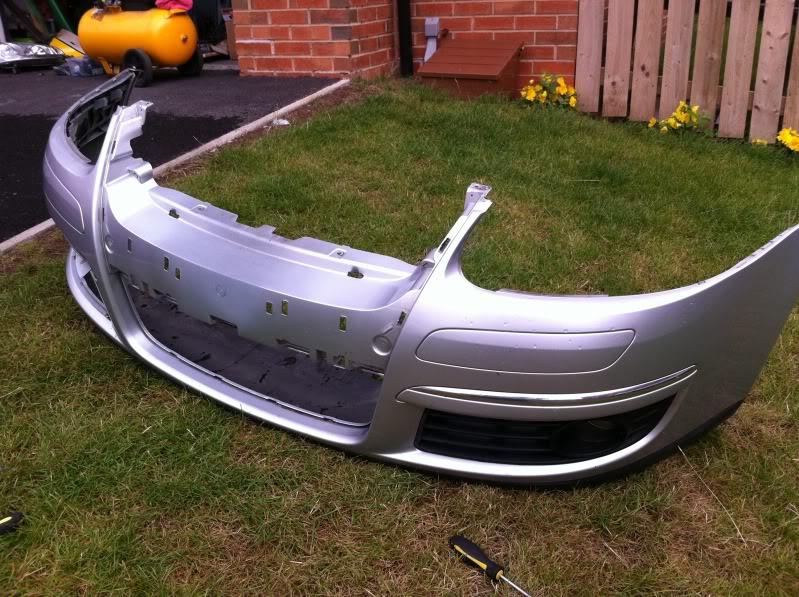

First thing I wanted to do was the remove the rest of the chrome on the front end and try and get it looking black and dark like the grill etc. Trouble is to remove the little over riders, you have to remove the entire front bumper. This is easy on a standard car, however if you’re a bobby knobhead and decide to lower your car, you have to get the front end on the air and get the rims off. So this is how Saturday Started out…
Its simple to remove and to be fair very easy to work on, around 16 torque head screws later under neather and in the arches, and two large torx ontop of the bumper, it simply popped off.
Then it was the strip down, the front side grills come out after one cross head screw in the corner, then popping the clips on the rear out and the vents/over riders come out in one piece. The large centre grill simply pops out.
I then removed the chrome trim surround from the lower grill and keyed it ready for paint. I then masked up the grills and over riders ready to paint them too. After a couple of layers of primer and a couple of satin black they were done. I decided on satin the same as the front end, so everything matched up. I also painted the top of the bumper too, as with the Gti honey comb grill you could easily see the reflex silver through the holes, so I masked up the area and sprayed it satin so that nothing could be seen behind.
Then it was time for the re-fot, about 20mins later it was all bolted back on, I like it but I think it’s a grower, ive been used to having chrome for so long I just need to get used to it all. I think with the carbon grill on it will look a lot nicer.
Im running it with an old broken grill as im rebonding the carbon one to the gti grill so it fits perfect. I also luckily had the help of my mates garage and use the pit (as I get beached on the ramps now :( )so we could give the car a longlife oil service as it was well over due. Managed to grab a cheeky photo but the lighting was crap!!

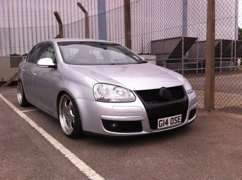

Managed to give the car a pre-festival wash last night, got the carbon grill back on after some rebonding and gave the wheels a quick buff. Still got loads left to do, but went for a few cheeky pictures last night, found a real nice lit area on the industrial estate think they came out quite nice. Coming soon, tinted headlights, another 15mm lower on the front, de-badged rear and last 2 door cards in, along with a detail for festival :)
