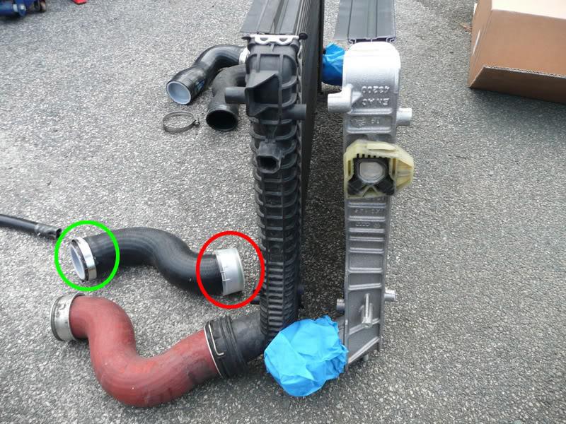

Right, I've got the red pipe in my hand and BOTH.. sod it.. let me get a piccy up.  Heres what I've got:

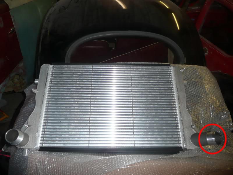

I still think there is a problem here, look at the pics to see what I mean..
This pic shows the S3 hose which one end (GREEN) pushes over the intercooler take off (RED 2nd pic) and is secured with a hose clamp. The other end (RED) has the hose connector on, with no o-ring, not that I can see anyways.. This end pushes into the turbo intake pipe on the driver side of the engine bay and is secured with a spring pin.
I still think that there is no o-ring on that connection which would cause a problem..

Jonny if you look at the pic of hoses I put up on the right hose in the pic it's got a jubilee clip on the bottom and at the top it's got a plastic cover over the top of it and if you look close near the top u can see the black o ring going around the top of it.

just had a look at the s3 hoses on mine and they 1000% have a green o ring at the top  :happy2:
