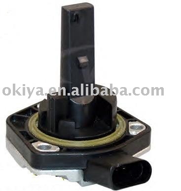

I'm pretty sure I haven't got this Oil Level/Temp Sensor on my 07 Leon, been under the car a few times and never noticed it.
However, if I look on the VCDS Measuring blocks like you have been, I too get an Oil Temp of -60 and a flickering Oil Level.
I'm going to have a look at Channel 39 when I get home to see if I can find anything out on there.

Cupra it wasnt until I started looking that I noticed the sensor and I have been under mine a few times to change DV and brake pads, if you have a larger engine under-tray on the Leon you might not be able to see it, the GTI one is rather small and doesnt cover the sump.
I'm pretty sure you got one.  :wink:
At least all cars with longlife from factory do have this sensor.

Well, been under the car and I can confirm that (at least mine) a Leon doesn't have an Oil Temp/Level Sensor.
I can see where the sensor would of been.
Also (think I did it correct) with VCDS under "engine" then Adaptation then onto channel 39??? I get an Error message. So thats it for me, back to a gauge.  :confused:

Thats a bit rubbish, it would be a new sensor new sump and wiring to the ECU and cluster so probably not worth the end result!  :sad1:

I don't suppose anyone knows or could find out (pretty please) the part number of the Electrical Plug that plugs into the Oil level/Temp Sender do they?
I'm going to retrofit this I think and need to get all the parts together.
The part number for the plug would help my dealer and I locate some parts.

This page should help you out, think it looks like 1J0 973 72 3
http://www.passatplus.de/umbauteile/stecker/stecker2.htm
based on this
It also appears froma  search that on the 1.8T engines the oil level sensor was wired into the coil-pack loom as ECS did a replacement loom, could be worth some research to see if there is a similar loom for the TFSI

On their they list 1J0 973 703.
Looking on the link above, this connector is just above, so I think I have found the answer.
