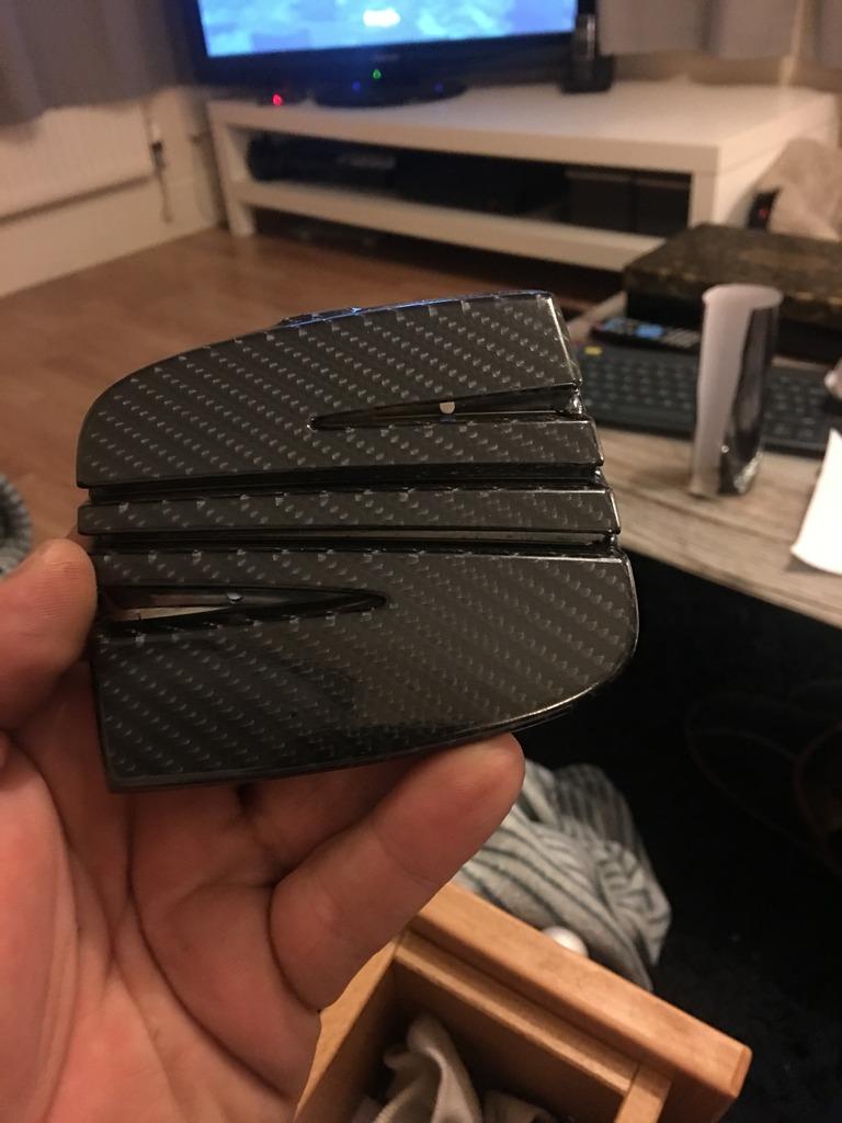

@monte re-wrapped my badge as the previous wrap started to look tired after being on quite some time

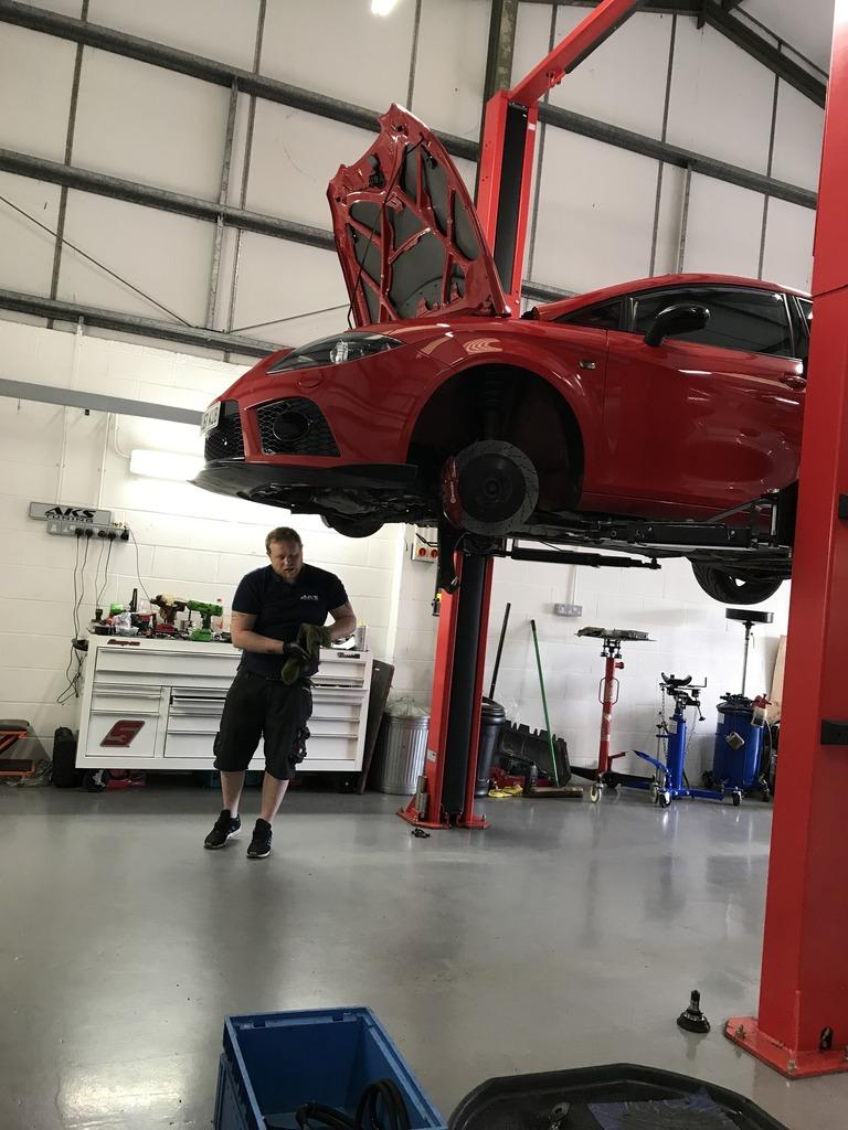

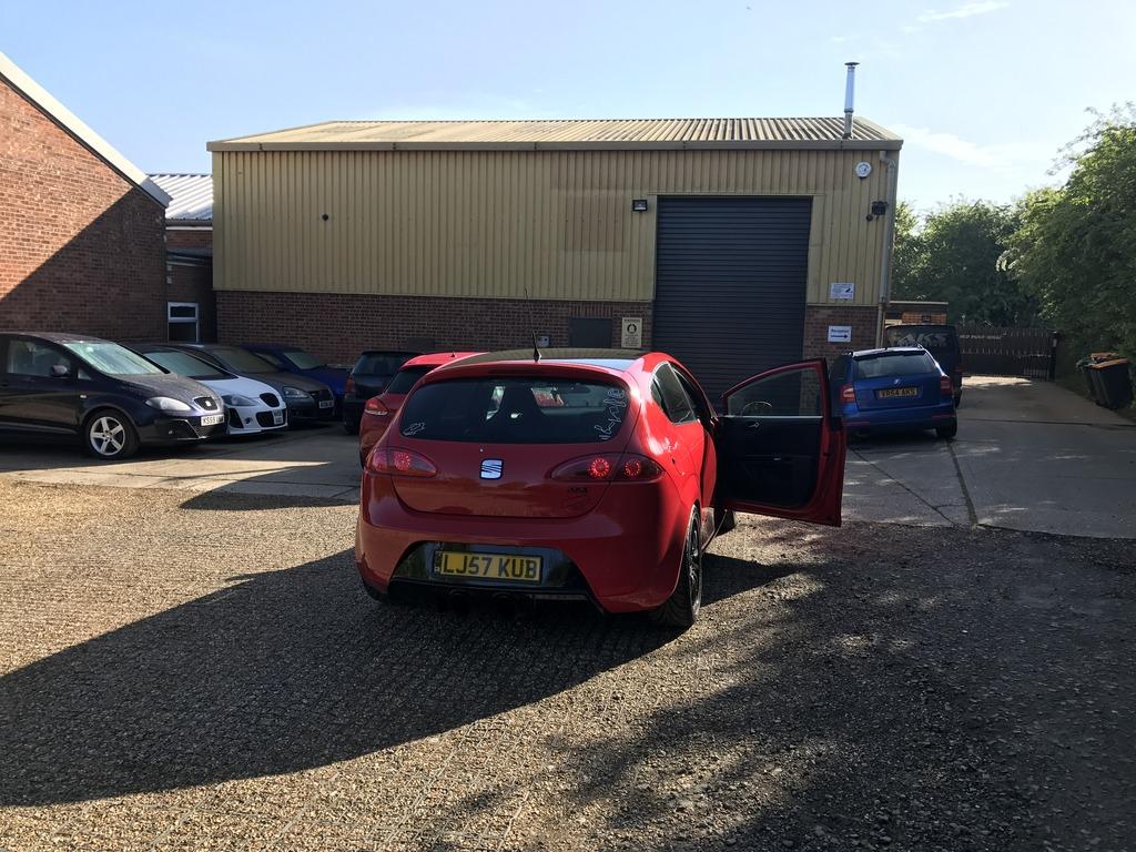

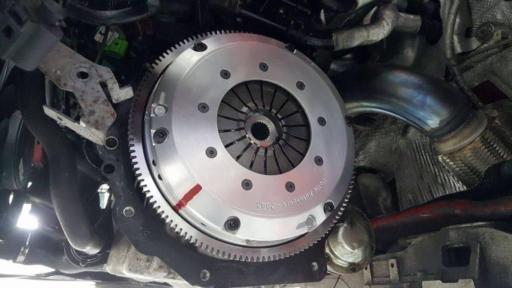

Dropped her of with Alex at AKS Tuning this morning before a short trip to the south atlantic;
Arrived a bit early...
So went for a sausage butty and a latte.  The car drove itself there as it's been there so many times before (The old AKS unit!)
Box off to remove the barely used Helix paddle...
Oil cooler that's going on;
Long awaited twin plate;
and the box strengthening mods begin;
May have bought myself a new carbon trackday helmet too 0:-)

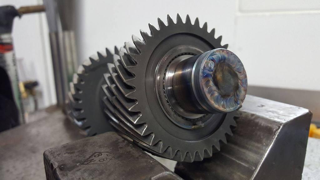

« Reply #3014 on: May 03, 2017, 07:01:52 pm »
Shaft beefed up;
Experimenting with cooler mounting....
  Unfortunately the previous owner of the cooler has had some of the mounting points cut off, which is really annoying but Alex has fabricated a custom bracket to get it mounted nicely.
