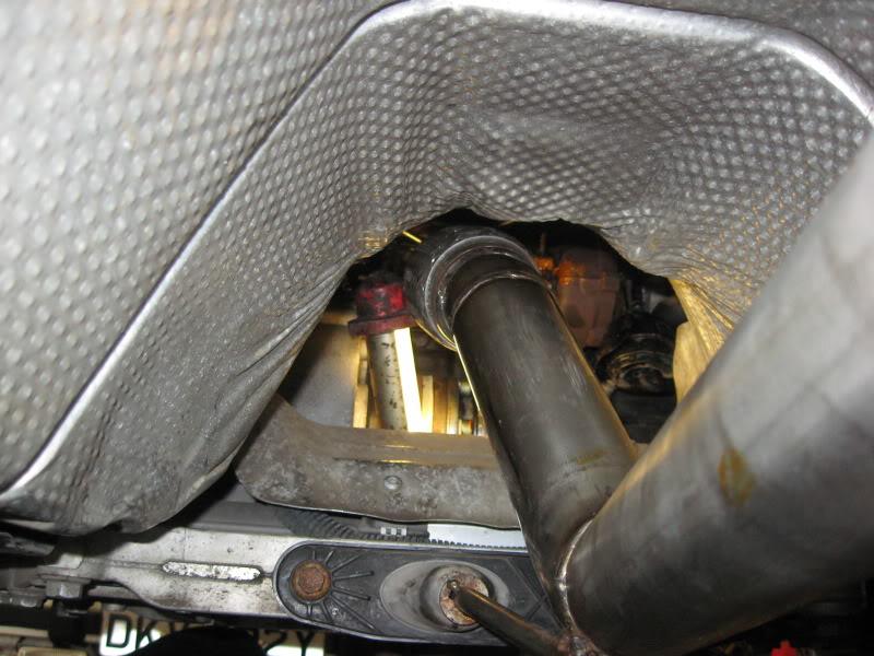

It felt different but the figures would say otherwise. It felt like it spooled up quicker which made it feel faster but the smoothness was the best thing about it although I only did 10-15miles before I went to the Shark Stage 1  :happy2: so maybe it would have been better over time.
Here is said Decat

How does the pipe fit to the turbo, it doesn't have a flange?

It uses kind of a large jublee clip
