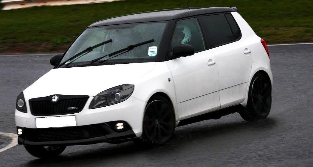

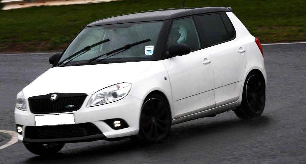

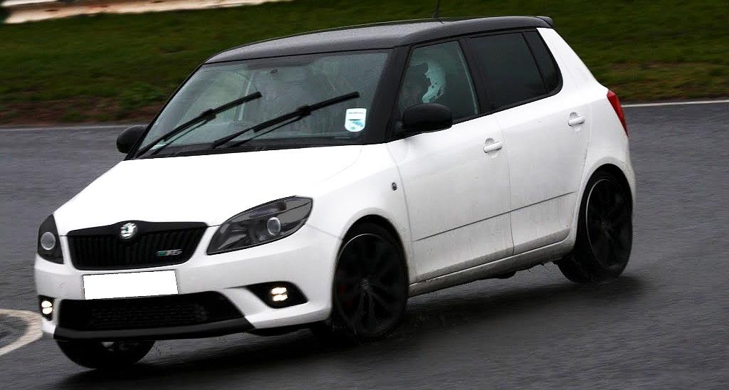

Ive been spending to much time around TFSI_Mike and im looking at vinyl wraps that have been applied to other Fabias.  Leons been photoshopping my car.  Whats your thoughts guys.  Its getting lowered next month on ASts so that issue is out of the way.  Was also thinking of maybe getting my big brake kit sprayed white, or should i do it black?
How it is now
With some black on the lower spoiler
Some black on the lower spoiler and tinted headlights like the new black pack vRS setup
A wider black lower splitter with tinted headlights
