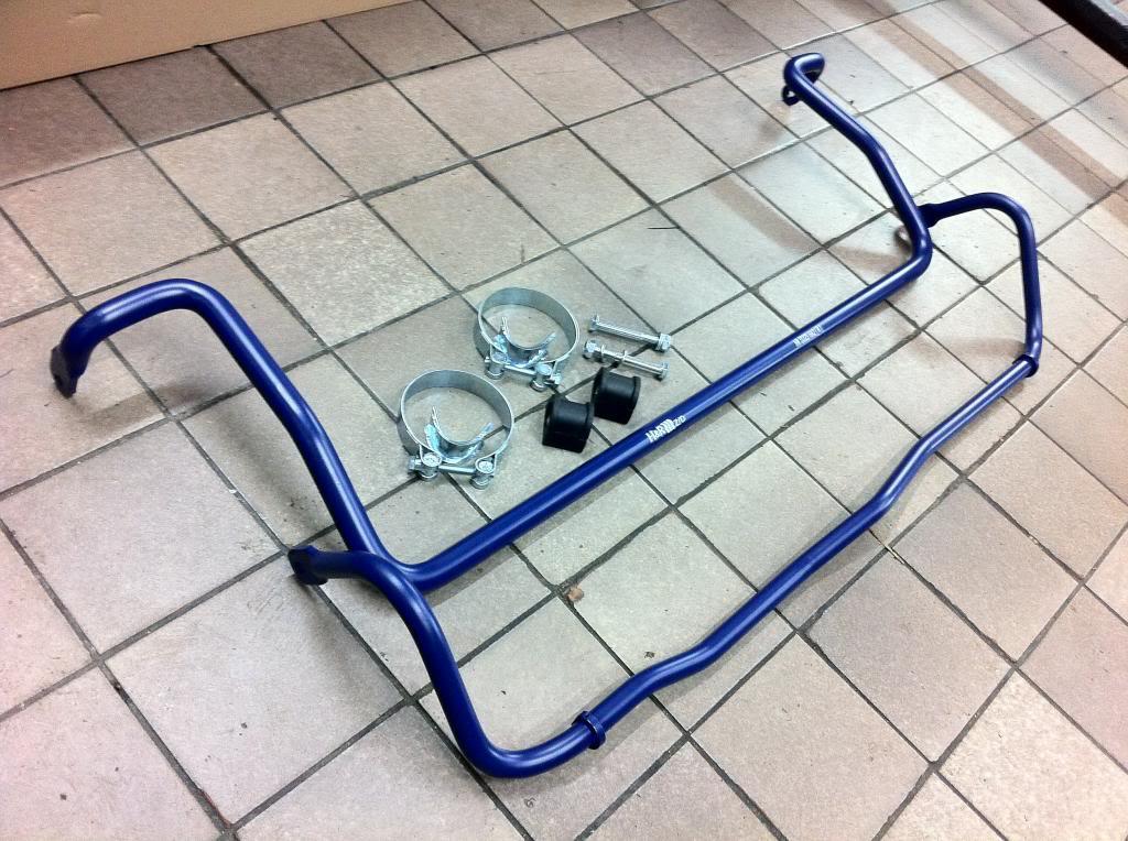

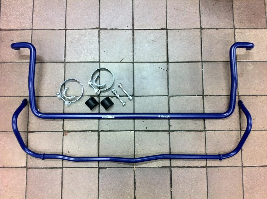

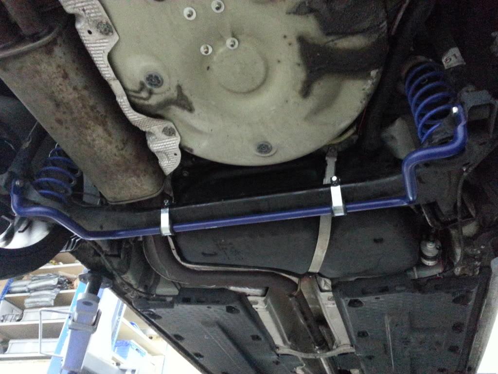

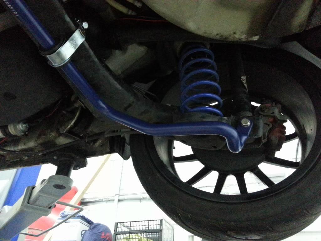

The ARBs were fitted today.  Originally i only planned for just the rear bar, but Alex had the front/rear kit in stock so rather than than wait for another single rear bar kit to be ordered i thought do the full kit.
Alex is doing a fast road geometry check on the car next.
Should be collecting the car, hopefully complete on friday.

Beasty 25mm rear bar  :driver: :evilgrin:
