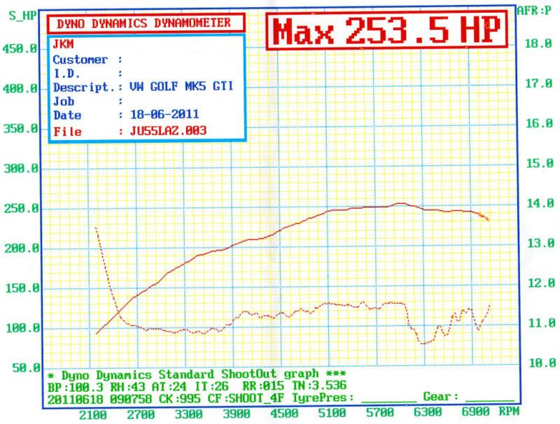

For you guys experiencing this squeal and if you are modified and running a hpfp then i would strongly suggest changing the fuel valve for an rs4 one. i had exactly the same issue and this solved it for me. Was only about £40 from audi. An absolute pain in the arse to fit but its down to the car requesting higher fuel and the standard valve is unable to keep the flow rates up. Most peoples RR graphs show a bad fluctuation on the fuel pressure. Unlike mine now with a constant flow and no noise  :pomppomp: Hope this helps and will try find my graph to show you all  :happy2:

First up is jussa who was running stage 2+ just like me with the only difference being the RS4 valve and then mine :happy2:
The fuel pressure is the dotted line for those of you who didnt know
Stage 2+ 280.4 bhp ITG, Revo Stage 2+, decat, hpfp, THS intercooler, THS engine mounts, Pcv revamp, sportline springs, rs4 fuel valve, DS2500 pads and brembo discs, braided lines, ATE super blue brake fluid and more to come
No it's not, that's the AFR (air fuel ratio)...   :confused:

oh ok my mistake but the guy at JKM said that the dotted line was effected by the fuel pressure and that the rs4 valve was the reason mine was more settled and didnt fluctuate as much
