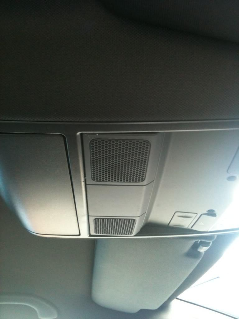

Got my replacement bulbs today, some nice SMD ones, but how the devil do I get in to change them haha?

For the rear you can pop the whole unit open, the vanity mirror ones can also be popped out with a screwdriver. The front centre ones require the 2 torx screws to be removed. I think you pop open the grille bit towards the rear of the car and that gives access to the screws.

« Reply #2 on: September 01, 2011, 04:54:50 pm »

« Reply #3 on: September 01, 2011, 05:32:01 pm »
It's the front I'm after, I have plenty of torx but when you say pop of the grille bit I got a little confused lol?
Sorry I was doing it from memory  :signLOL:
The bit with the holes in can be prises open, I did mine from the left of the photo (you can just about see the mark)

« Reply #4 on: September 01, 2011, 06:22:47 pm »
