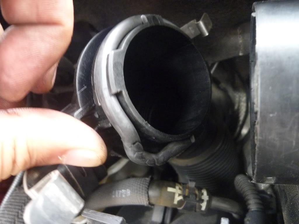

After trying to figure out the mystery of why the handle of my oil filer cap wasn't sat at 9-3 oc'lock, i removed the engine cover to have a look at the oil filler extension tube, i noticed when a removed the air hose from the MAF, the seal looked a bit knackered:
I think its a no brainer that it needs to be replaced, if this seal was leaking air, what would the symptoms be?
Does anybody know the name of this seal and if it can be ordered on its own?
As always, thanks in advance for your help peeps  :happy2:

There is nothing listed on ETKA, I might have a spare turbo connecting hose with one of these in the garage, I will have a look later.

I had to replace one on my Ed when I first bought it.  I seem to remember it came as part of the hose.  Crazy I know.
I would try and re-use it in the meanwhile, you can't make it any worse.

Ive just seen a diagram and you're right, it's part of the hose assembly - its strange as VAG normally have rubber seals listed seperately for most other bits  :sick:

The intake pipe is 06F 129 627 H for the K04 car that includes the take off port for the DV.
