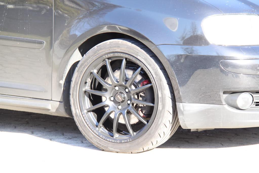

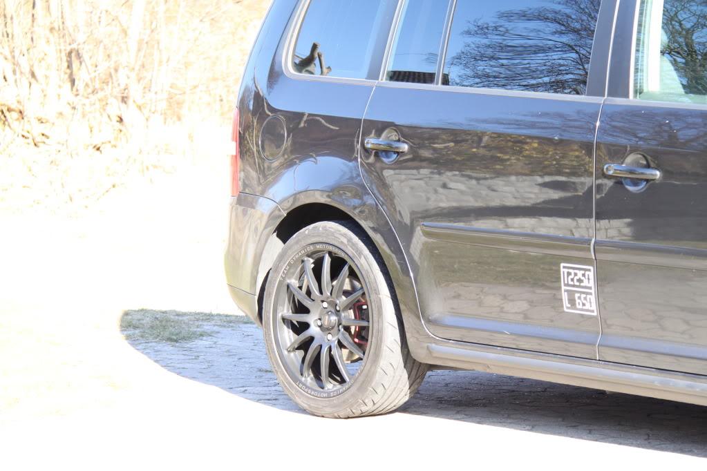

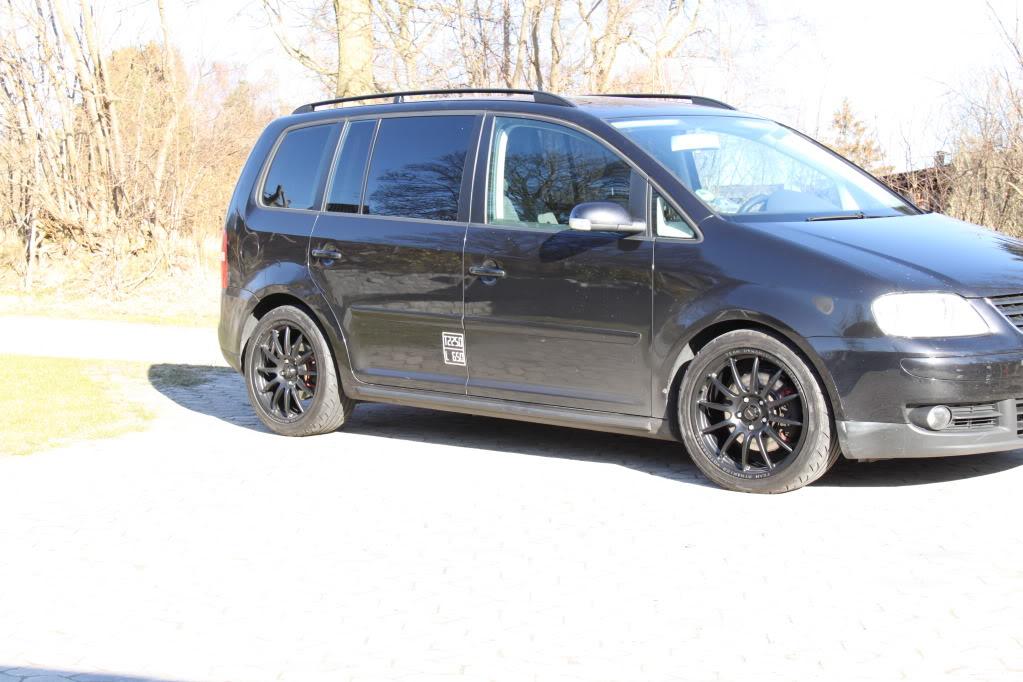

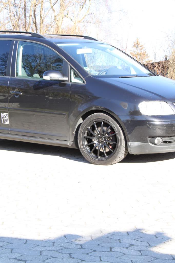

Today i had time to get the summerwheels fitted, looks better than the silver ones IMO.
Over the top mod list ;o)

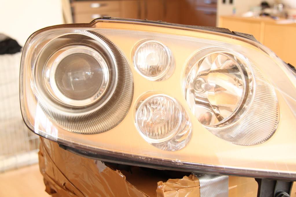

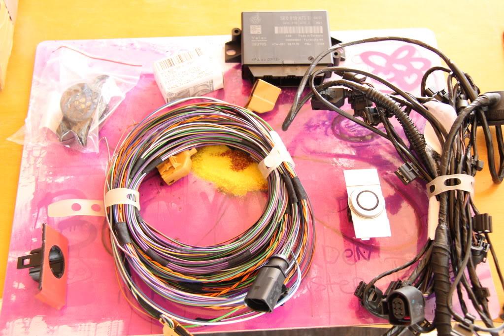

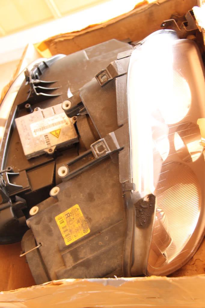

I would love to let you have a go at the Touran and some extra small mods on the Golf Darren, maybe we should combine it with a tour around Denmark as we have 6 available seats in total in the Touran and Golf.  :drinking:

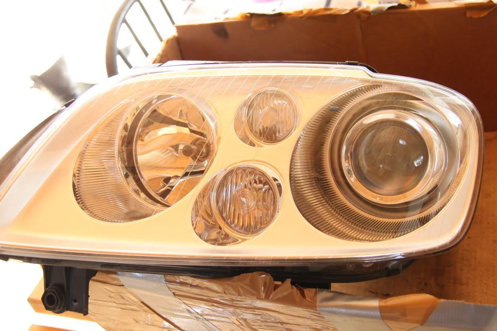

Here's some shots of the parts recieved so far
OPS
Xenon
I also have recieved the wiring for heightadjustment, but i forgot the adaptors for the headlights so package number 2 is on the way from Kufatec.  :ashamed:
