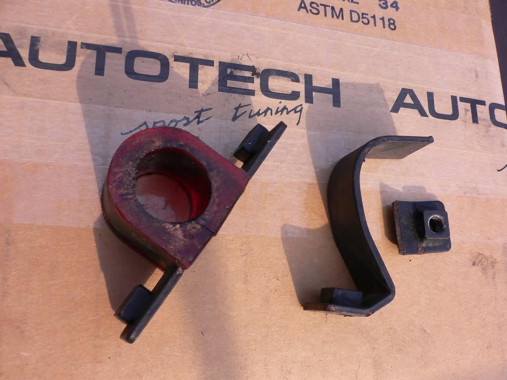

The Autotech Front drivers side bracket has snapped yet again :sick:
This is now twice in under a year. The first time a replacement pair of brackets were fitted that were thicker than the first, yet one has still broken again.
I don't know what to do now as they both catastrophically snapped at low speed whilst turning a tight corner. I'm basically going to be driving on tenterhooks all the time thinking that one may go again. I daren't take the car on track for fear of a failure at a higher speed and basically want the front ARB back as a stock item or something like an Eibach ARB replacement....at least something I can have more confidence in :scared: :scared: :scared:

The ARB is a 25mm hollow construction and is purported to be as stiff as a 25mm solid bar with only 70% of the weight. The ARB should be fine, but the brackets (even the newer ones) look like they have been cold pressed into shape with 90 degree angles that are too sharp for the steel and therefore inherently weak at these two points. Both brackets have broken at the same point on the 90 degree bend and both under the same circumstances (very low speed (10mph ish) tight bend). I'm waiting on a call back from JBS to see what they can do for me. Having brackets on a car that are so weak that they can't stand up to normal road use at low speed is a complete joke and as I think about it more, the more p!ssed off I am getting about it.

but I've never heard of the brackets snapping when using other aftermarket ARB's, Eibachs etc, I've used them for 15k+ plus, so has Joe and countless others, maybe the Autotech ones are stiffer thats what I was thinking :smiley:
