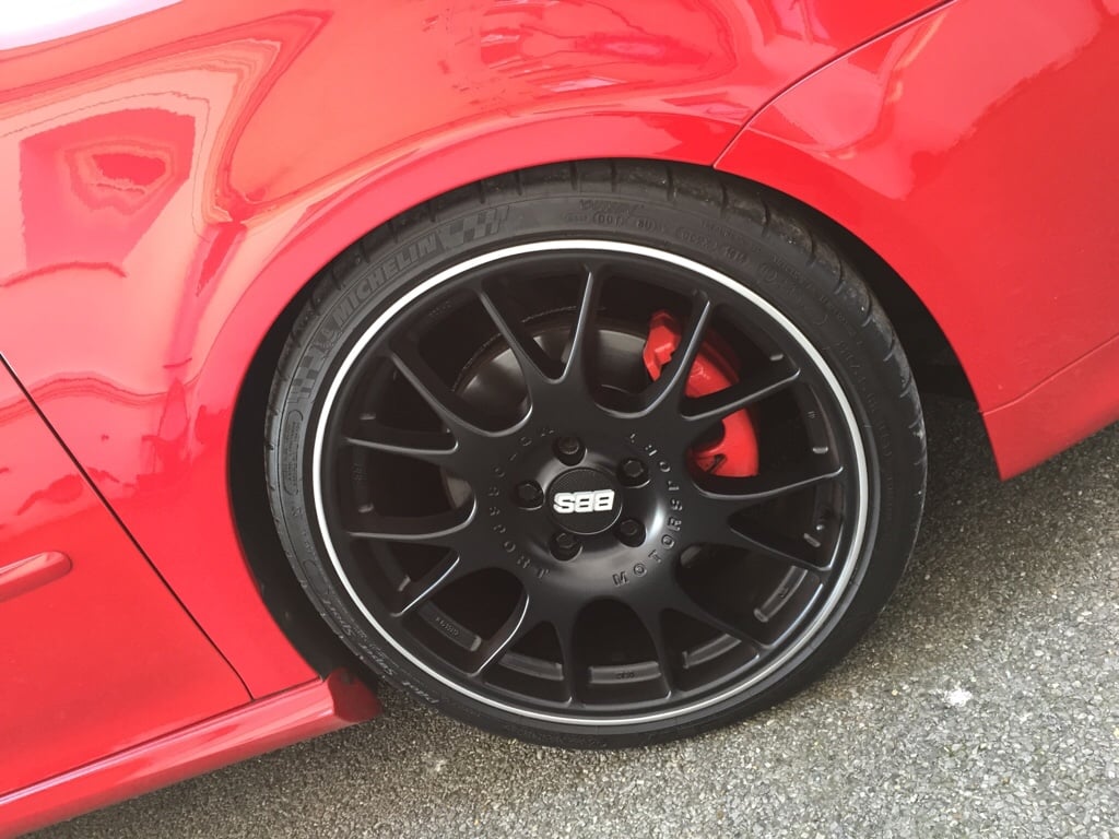

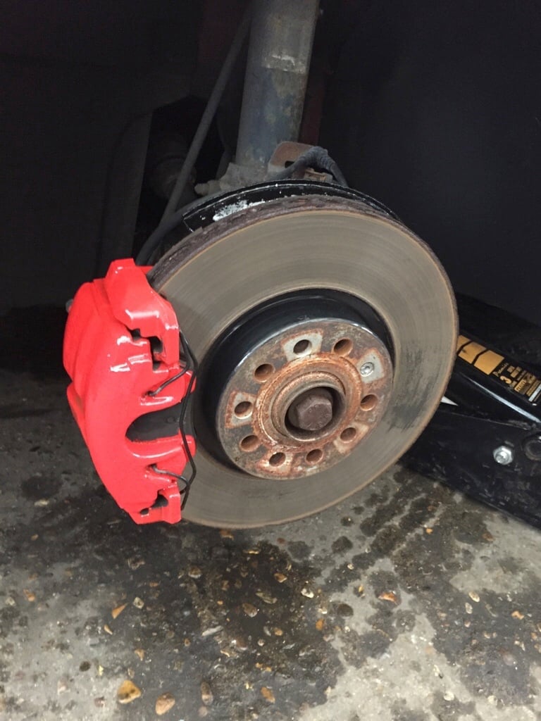

Gave the calipers a bit of a refresh with some fresh paint. Also cleaned up the inner wheels and removed the old wheel weights myself ready for the new tyres..

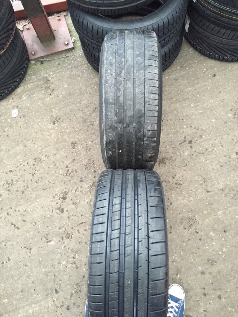

New Super Sports have squarer shoulders than the conti's so seem wider even though both are 225/35/19. They are loads better than the Conti SC 5p. much sharper turn in. I'm getting a sharp and brief metallic rubbing noise occasionally now though when on turn in and it hits a bump. Cant see any contact in the inner arch at all though so not 100% sure its the tyre. Wondering if the top mounts have just happened to go at the same time??

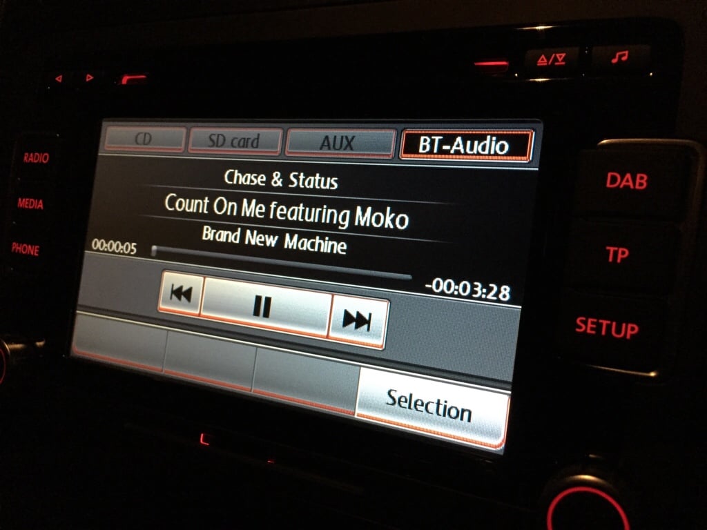

After playing around with a few different bluetooth modules and head units I finally got the bluetooth streaming working as I wanted with the track names coming up on screen :) Had to swap the RCD510 from a A revision to a G revision and install a 7P6 J revision Bluetooth. Now works seamlessly with my my iPhone 6 bringing up all the contacts in the correct format and shows track names with bluetooth music streaming.

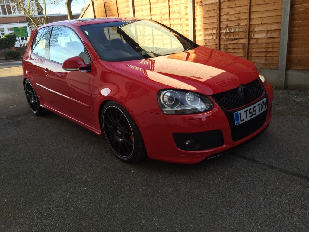

Gave it a quick refining polish and fresh coat of wolfs bodyguard

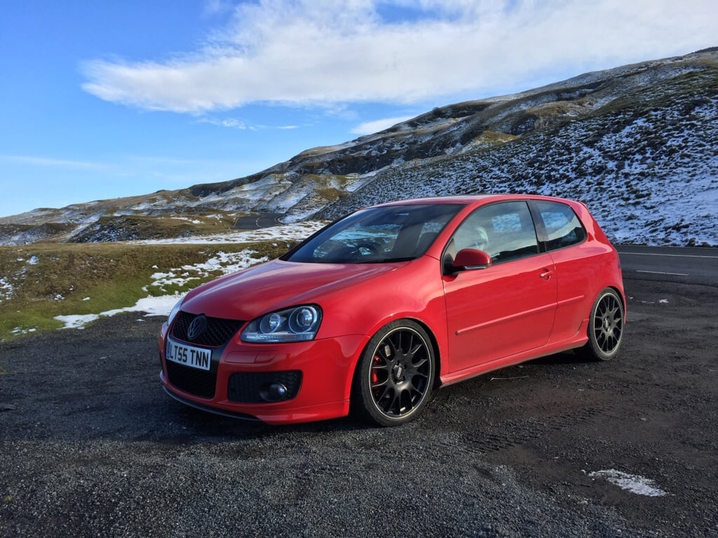

Then after all that work... I thought it was about time I actually drove it... Filthy already on the A4069 in south wales
That's a nice back drop there Nathan.

Looking tidy as f*ck @jedi-knight83
The wheels couldn't suit Tornado red any better. Performance & new DV sounds good too, looks like you're enjoying it from the ace shots  :happy2:
