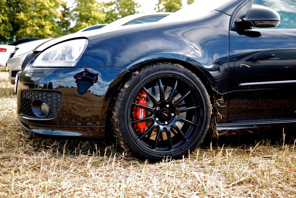

I run 35-40mm lower at the rear and 20mm at the front. I have a lot of extra track...
Wheels ET45 8x18 so the outer edge is 12mm a side, plus the TT bottom arms which add track in order to add camber, this adds a further 12mm at the hub centre and 6mm at the top arch.
So at the arch lip nearly 18mm additionally track per side, so total track increase over 36mm at the arch, nearer 48mm at the hub and more again at the bottom of the wheel as I run 2.15 degrees negative camber at the font. I have not had one touch of the arch since, I have been cornering hard over some very undulating surfaces and it's been prefect  :wink:

Can you stop posting photos of your car please.... It's making me jealous.
Does the camber on the front make a lot of difference?
Offline Carrera2RS
  • Posts: 503
Re: VWR brakes, very disappointed, but hoping to feel better !
« Reply #62 on: October 03, 2011, 10:08:29 pm »
Sorry for all the pictures  :ashamed:
Yep the camber (and I suspect track) makes a marked difference. I explored the chassis balance at much higher speeds than your big roundabout speeds to see how the balance might be at much higher speed. It was remarkable and was still very planted and when I did feel the weight transfer uncomfortably load up the rear and hinted at braking away, a touch more throttle and it was back to neutral. Turn in is excellent with front camber. Understeer is virtually a thing of the past  :wink:
