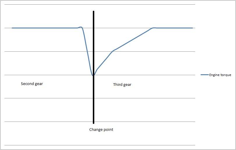

To be clear the torque limit I have issue with is the post up-shift torque dwell, not the in gear element. The peak torque on a dyno run is still being modulated by the DSG gearbox (which I accept) at around 280 lb/ft.
I will draw a crude graph to show what I mean.
The reason it bugs me is that it totally negates the benefit of the DSG - I'm far from a driving legend, but the torque interuption I introduce when shifting my manaul track car is seemingly less noticeable, though I've not quantified this with a Vbox or similar. I know from driving the other day with a friend in a fairly spirited manner, that when my car changes gear he pulls on me in a way that shouldn't happen.
As I exhausted conversation (a while ago) regarding the map being the cause the torque-dwell, I don't mind disclosing that it is a Shark map on my car, as Heavyd has eluded to.
« Last Edit: January 23, 2012, 12:34:26 pm by alackofspeed »
perfect graph showing the issue.
AS soon as i get my car back I'll be back at Motech trying to sort the issue.. the good thing is they also seem committed to sorting it out and are not just telling me to live with it.
