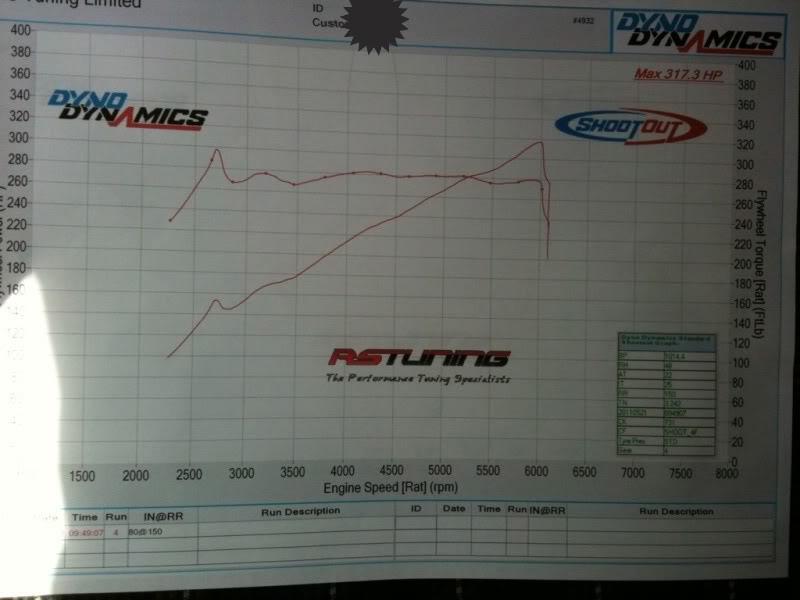

Heres 2 examples of Torque limited maps

My K03 map results in a similar initial shape whilst the turbo has enough puff to hit the torque limit - when logging in VCDS you can see the closed loop control of the torque, and further evidence can be seen in the MAF values and ignition pull.
The peak torque trimming is a seperate issue to the post up-shift annoyance to my knowledge and is the engine pulling timing at the request of the gearbox, which I accept.
The post-shift issue happens at torque values lower than the maximum levels dictated by the g'box. I can't recall exact figures but I'm sure I have logs where the torque is being pulled back around 200lbft and lower.
In gear pulls in my car are not a concern of mine; a K03 stg 1 doesn't really justify any further torque handling headroom. The focus of my attention is the up-shift torque dwell.
