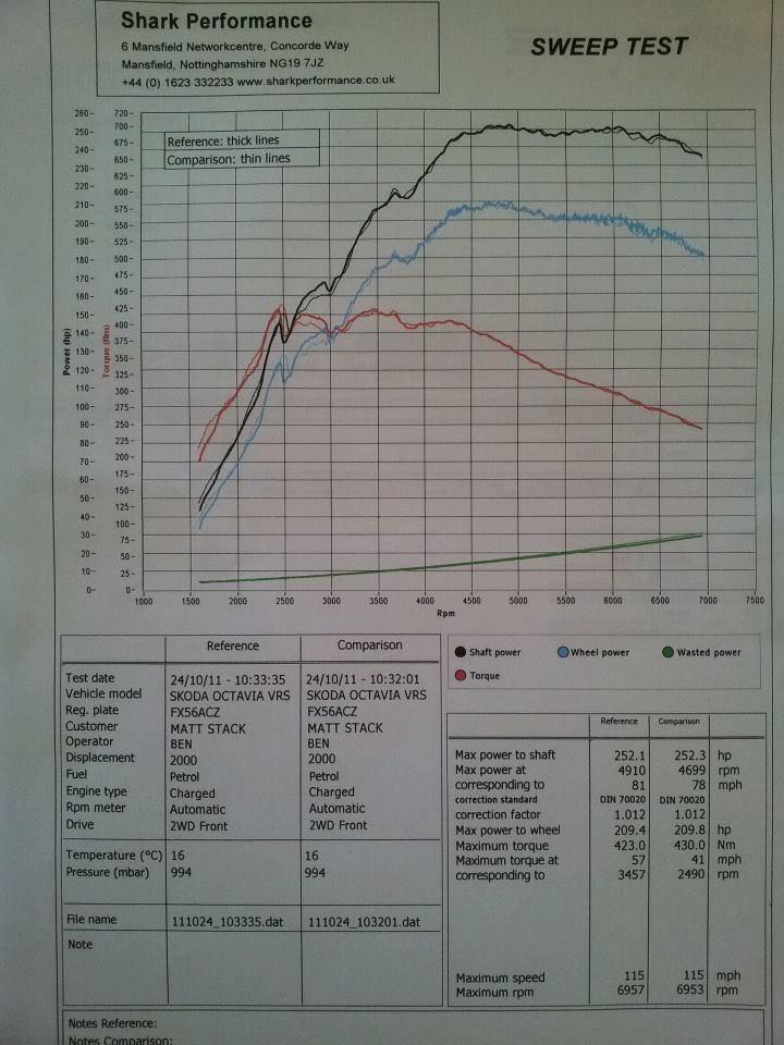

Offline 56OctyVRS
  • -Receive: 72
  • Posts: 1003
Re: MK GTi vs Ed30 - performance potential differences.
« Reply #13 on: October 25, 2011, 07:06:37 pm »
Depends on how you drive as the k03 (smaller turbo) is spooled up earlier in the rev range and has more low down grunt than a k04 car. At mid to high revs when the k04 is fully spooled, it'll keep pulling till the red line whereas the k03 will run out of puff by 5.5k.
[/quote]
Thats not entirely true as my Octy Vrs K03 has been on Sharks rollers and puts out a healthy 252 bhp almost from 4000 to 7000rpm and holds the power well.  I have got misfires lowdown which is probably plug related but that will get sorted.  Id still opt for a ED30 as they are far more tuneable though.
