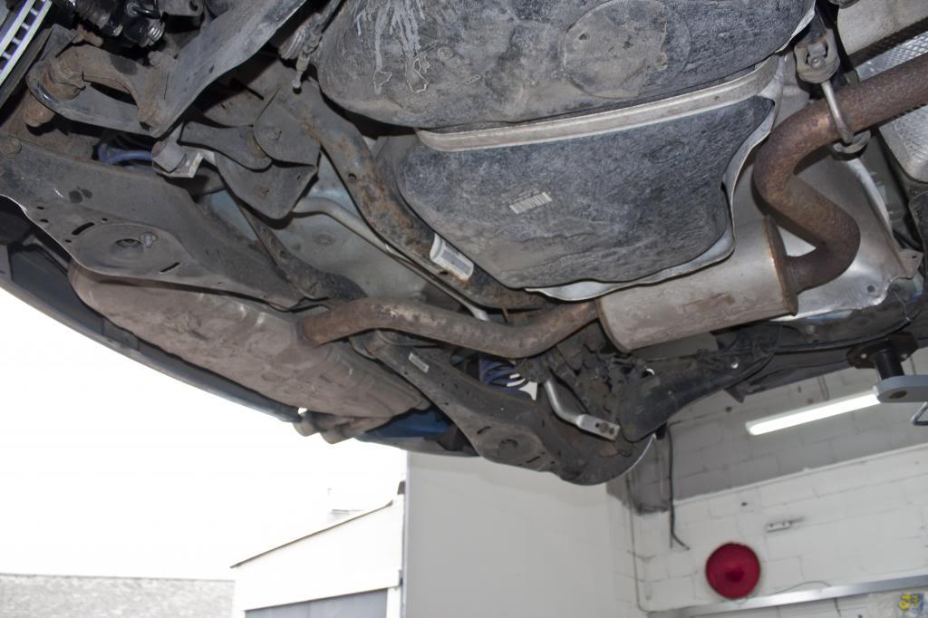

So here is my first proper update for 2013. Saturday saw another visit to Alex at AKS to have a few bits fitted which I had collected over the last few months. These were a full S3 brake setup, Darkside Developments DPF delete and full Milltek.
Here's how I got on.
Before photos of standard front and rear brakes:

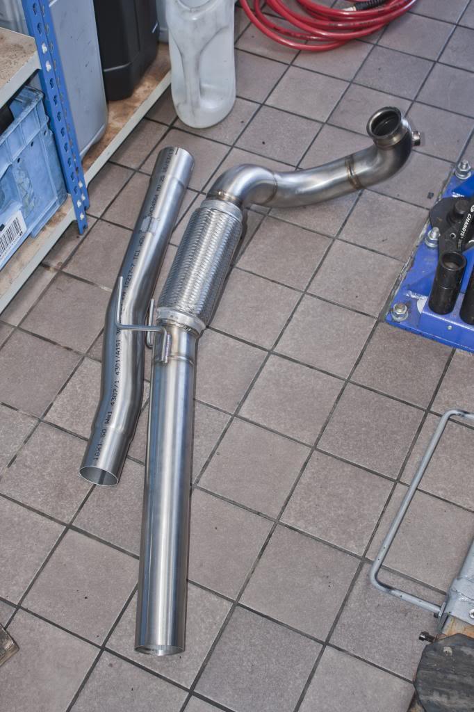

Once all the brakes had been bled through it was time to fit the exhaust. First up was the 3" Darkside DPF delete. Lovely piece of kit. Nicely made. A bit too nice to not be seen really. I chose the Darkside pipe over the Milltek one as first of all it was cheaper, even with any discount that was to be had on the Milltek. And now I have seen it, the quality. The first thing Alex said was how well made it was. It has a longer flexi which helps stop any cracking issues. Another thing with the Darkside pipe is you can junk off most of the sensors. It only retains the lambda sensor. Pressure sensor pipework was binned leaving it connected but blanked off. Also the two DPF temperature sensors are now redundant and tied up out the way. We did try disconnecting them but it threw a fault. They can be mapped out however if I ever wanted to.
DPF delete and Milltek 3" - 2.75" adaptor:
Photo showing standard DPF junk against the Darkside pipe.
