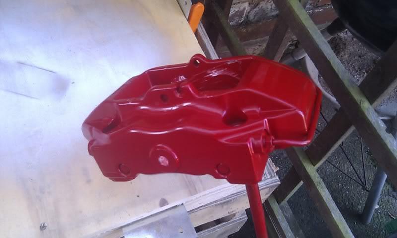

Brakes are nearly ready to go on (from my '330mm brake conversion' thread. Still not sure whether to go 'AMG' or 'Porsche' with the decals :confused:
Not quite DAveB standard refinshing but once all lacquered they'll be fine!
