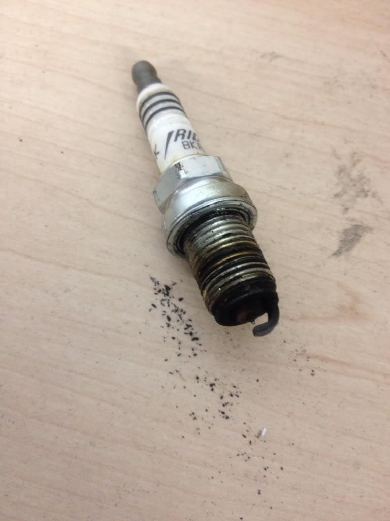

I had my BKR8EIX plugs in for a similar mileage on my K03 also, they seemed to work well and have had no misfires but when I checked them recently I found this-
They were massively coke'd up and had loads of carbon deposits. I changed back to the hotter "7" plug and since the engine actually feels like it's got quicker which may have over the last 600 miles burnt off excessive carbon deposits. Worth thinking about, they may not be any noticeable running issues but since changing back the engine seems stronger.
....I think this illustrates very well why it's good practice on a tuned car to more regularly change plugs than suggested in the car Handbook. I change mine (iridium heavenly sevens) every 20k miles.
Thats how mine looked. Unless you drive the car hard you wont burn off the carbon deposits with the 8s. These are a plug more for track days than normal driving. Since fitting the 7s my car hasnt missed a beat and feels loads beter to drive.

Mine were the same as I had a misfire so pulled the plugs out and everyone fecked

I too ditched the 8's back to the oem 7's and confirm mine feels a lot stronger especially at top Revs.

I think the 8s are fine if you do long drives and use the power a lot. I now only really do local commuting and the 8s are too cold for that. They carboned up very badly and made my engine run very harsh. Initially they were fine when new but after carboning up they werent. I switched back to the 7s and the car is running fine again. The 8s are an ideal track day plug when you want to use the power for longer  but I think the 7s are more suited to road applications no matter what power level or turbocharger you have fitted.
