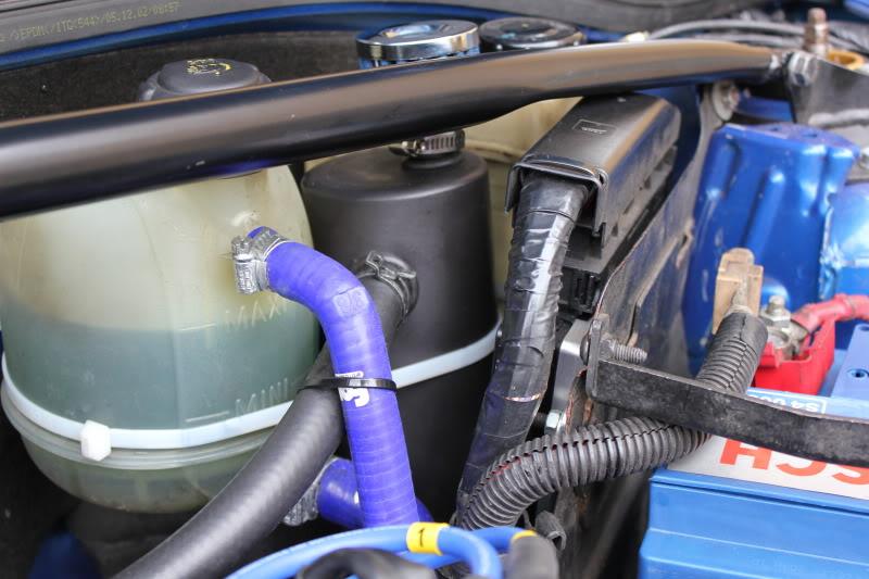

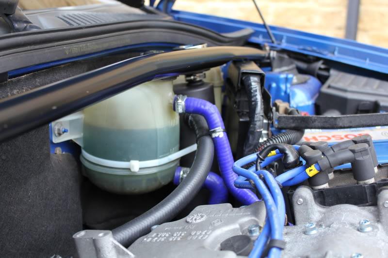

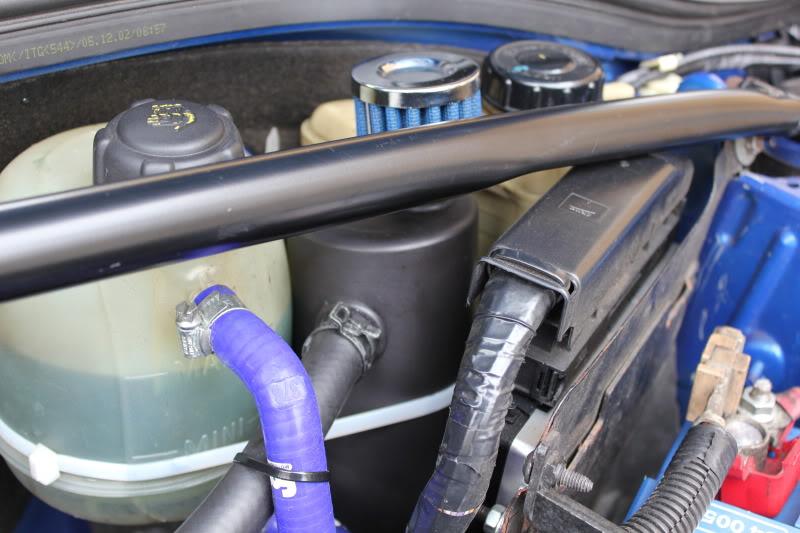

Well I sorted the breather out, and was going to buy a catch can this week.
I did some looking at options, and they were all a bit max power stylee.  So I set about making my own.
From this
to this
It is a Sigg type aluminium fuel bottle, turned upside down, with a port in the side, and a port for the breather filter on the top.
I cut the holes with my trusty cone cutter, and used decent grommets, and a poly pipe insert (22mm).  Bit of black spray, and i now have 1 x Catch can.  To check the level I simply take the filter off, and dip it with a screwdriver.
To drain (which I can do in situ) I remove the bung that is normally the filling point.
Cost - some tube (already in garage),some grommets (50p), a flask (£4.99), a filter (already had)    and a 22mm pipe insert (30p), so less than £10.
Need to sort a bracket, at the mo it is ty-wrapped to the expansion tank, and is fairly sturdy.  Was thinking of a cheap bike drinks bottle holder bolted to scuttle behind.
Used a similar bottle to the below.

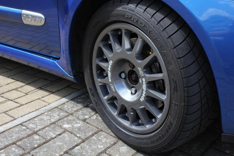

Winning combo - Willwood/R1R's, and Speedlines..........

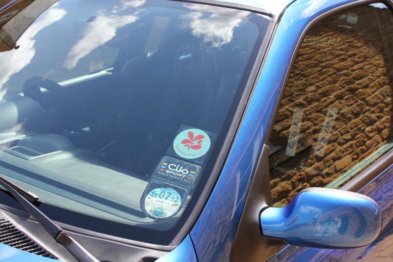

Quite funny having a National Trust sticker on a caged car!
Offline QD MBE
  • -Receive: 102
  • Posts: 2497
Purrfect weather for some enthusiastic driving this morning in our neck of the woods, eh, Dave  :happy2:
Out at 0545 for nigh on 3 hours, didn't take a camera, the weather was fantastic, went down towards your neck of the woods, then the coast road towards   Portesham, then over past Hardy's Monument, then Dorchester, then Verwood, and bck via Sixpenny Handley and Zig Zag hill  :evilgrin: (which was totally empty for the first time in the clio - Diff worked a treat!) Shaftesbury and back via Castle Scary.
Stopped for a coffee.
I thought the NT sticker would be a slight contradiction..............

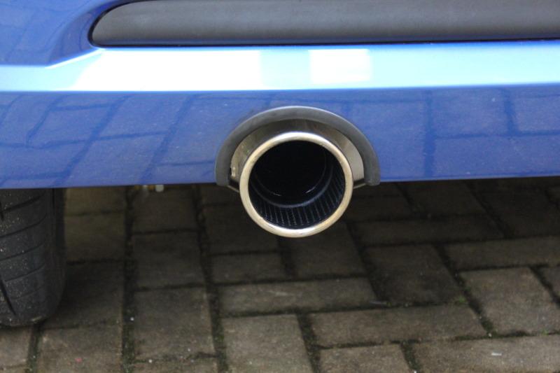

Made my own exhaust mounts, bought some generic Powerflex exhaust mounts from the bay, and fashioned them into the Renault casings, and the result is a really well suspended exhaust now, which moves just enough to compensate for the solid engine mounts.

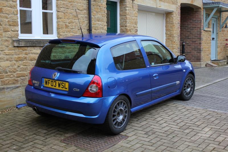

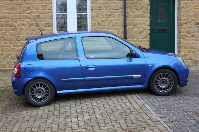

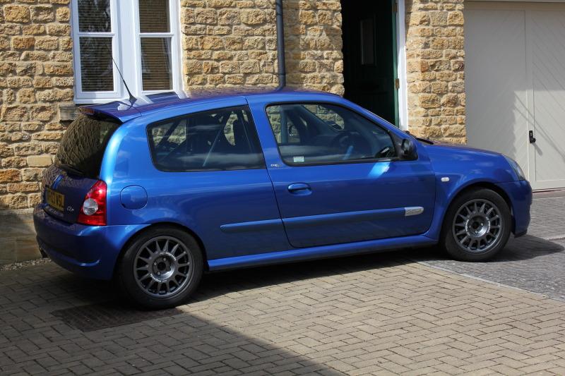

Gave the car a touch of a clean, well threw a bucket over it.  The car comes up quite well, and is a track car after all.............
Also replaced a lot of corroded fasteners with decent BZP Cap headed bolts.  Looks so much better.
Pics.
^^^^ Exhaust sitting well.
Clean - ish

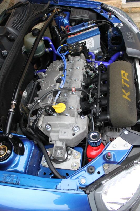

^^^^ Business end.  Catch can is in bottom right.
