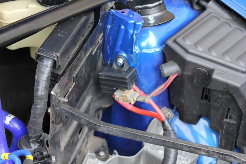

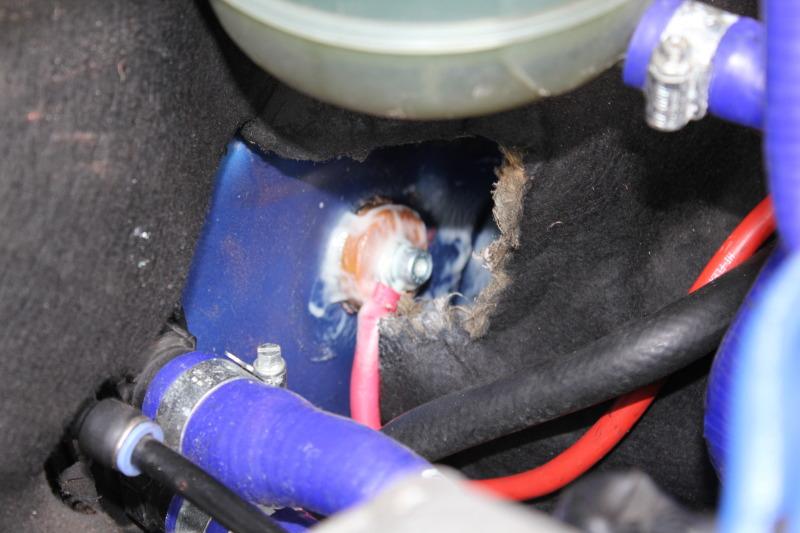

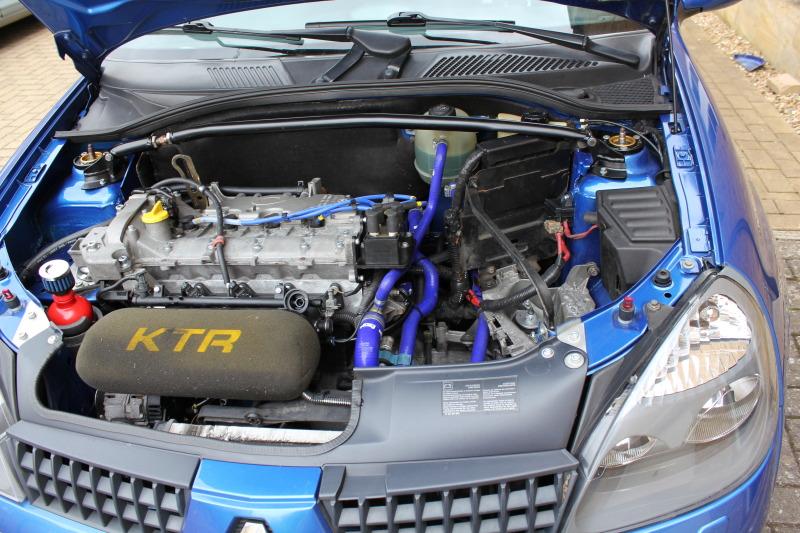

Well had a bit of spare time.  Took something out of the front, and smashed it in the back................ :laugh: :laugh: :rolleye: :rolleye: :rolleye: :rolleye:
I made a strong stainless tray myself, getting me welding eye back in :happy2: :happy2:, and bought some transit tie down rings from the bay, which are secured on the 4 bolts that are securing the tray to the boot floor.
Fused with 150 amp Mega fuse near the battery and also at the starter end (standard Renault fuse), and made a bulkhead through connector myself.
Lashed down using some straps from the bay, with a 900KG breaking strain, and a really strong cam lock fastener, they are f'in tight! The battery is going nowhere!
The whole thing is bolted using HT 7/16 UNF bolts and 4 x Harness 3" square stress plates.  I was thinking about a race battery, but wanted to be able to leave it outside without a trickle charger plugged in.  So used the std battery.
Pics
^^^^Stress Plate

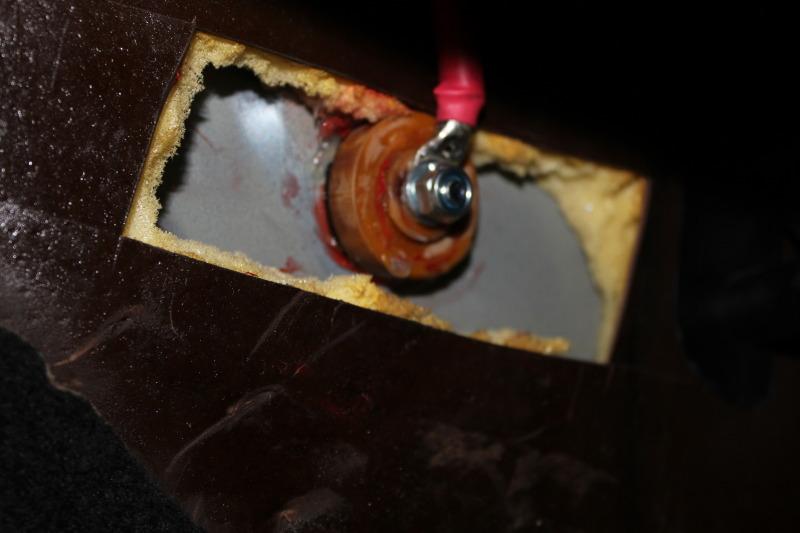

^^^^Bulkhead through connector with lots of wax.  waiting for the Rubber cover to arrive!  Should have been here friday!! :fighting:
^^^^^Battery in tray with lashing straps.  Catches are tucked behind, so as to stop inadvertent unlocking.
^^^^^Engine bay looking far more open............
^^^^^ needs a bit of a clean up, The red stuff is heat resistant sealant, which has gone off.  Just need to get upside down and clean to off.
