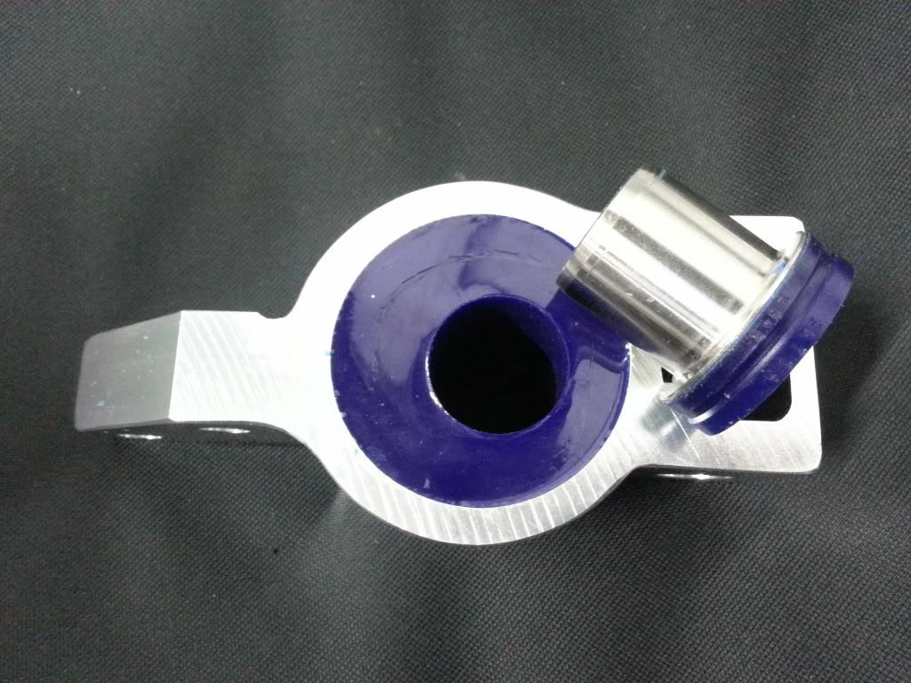

Not worth going straight for the SuperPro ALK then?
Pic of the bush showing the offset and the insert quality:

I had the Whiteline ALK on mine with no issues, however i only had it for 20k before selling the car.
given the amount of cars ive now seen that have eaten through the whiteline bushes I wouldnt go that route again.  Superpro seem the way to go IMO
It would probably make sense but i'm not convinced by offset bushes, though I know Superpro are considered the best in terms of polybush quality!
