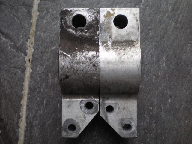

the WALK should fit all Mk5 platforms excluding the 4wd ones as far as im aware.
so that includes mk5 golf, mk2 leon, mk2 octavia, mk 2 TT and the new A3.
dont know if it will fit the R32 or the S3 though
 As S3 bushes fit the Golf > WALK should fit the S3 and R32.
"You get what you pay for."
The WALK does fit the S3 and R32 but not the TT MK2 AWD as yet . . . it does fit the  TT FWD tho . . . .

« Reply #229 on: March 12, 2011, 03:09:17 pm »
No, the aluminium bracket of all TT 8J have a different shape, no matter if 2WD or 4WD.
(as everybody knows, who have fitted the TT arms)
The only ''offset bushes'' that fit the TT are the ones from SuperPro. Laurent has them on his A3.
 :drinking:

« Reply #231 on: March 16, 2011, 07:16:09 pm »
I wonder how the Whiteline ALK fits the TT as the TT bracket doesn' fit the Golf, A3 and so on.
So the the Golf bracket should not fit the TT and the WALK should not fit the TT as well.
Even Whiteline told me the WALK does not fit the TT.
Maybe this guy did some modifications to the bracket. Can you post a link?  :wink:

Yes, the Octavia is the same as Golf, A3 Leon and so on.
The TT arms do fit to an Octavia. No question.
But: the TT bracket don't. The TT brackets have a different shape.
If you want to fit TT arms to an Octavia you have to reuse the
original Octavia's brackets (or the Whiteline ALK) as you have to on
Golf or Leon.
So the Whiteline ALK does not fit the TT.

The WALK for the GTI wont fit the TT, but the WALK for the TT FWD will  :smiley:

The TT console is similar but has differences to the gti console. GTI on the left
