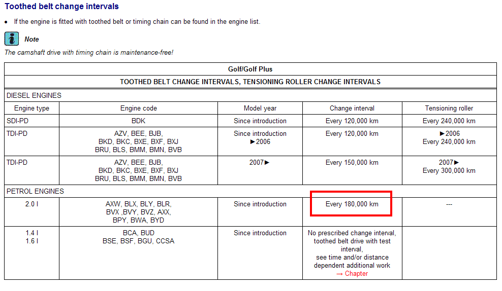

ELSA seems to think it's 180 000Km, which would put it about 120k miles in our money.

Surely this must have been changed though? because regardless of who I've spoken to VW or independants they're stating otherwise regardless of the service regime you're on.
Obviously in 2005 it may have been the case as stated in the service book but at what point was 4yrs or 60/40k introduced?
For example what does it say in service books issued with a 55/06 plate cars etc????

My 07 GTi handbook says check at 60k then every 20k, and change at 120k miles.
