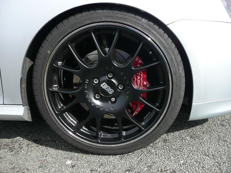

No No No
TAROX 10 pots are the future.

I ran Tarox on my old APR Stage 3 car and had more track use than hot dinners....Carbon Corsa pads were excellent on the 6 pot kit. 330mm discs and bells were expensive to replace though!
