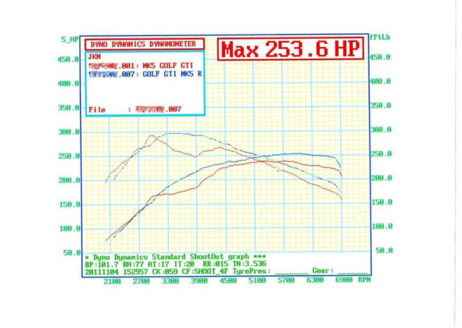

Here's my graph from last time, when my earlier map was changed to Revo stg1 and the ITG was fitted. You can see how much my car liked the viezu map  :confused:
From comparing from graph from yesterday to the above, i can see & understand what you're saying. Car doesn't feel any different to drive though.
Jim's comments on yesterday was that the car is running great, but map needs tweaking to accommodate the twintercooler.
