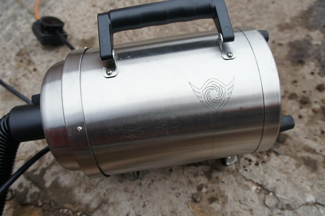

The car was then re-foamed, rinsed and dried with Uber Towels.  I also used my Aeolus 901X to blow dry the car removing any water trapped under wing mirrors, around wheel bolts etc:
