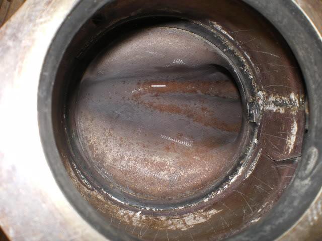

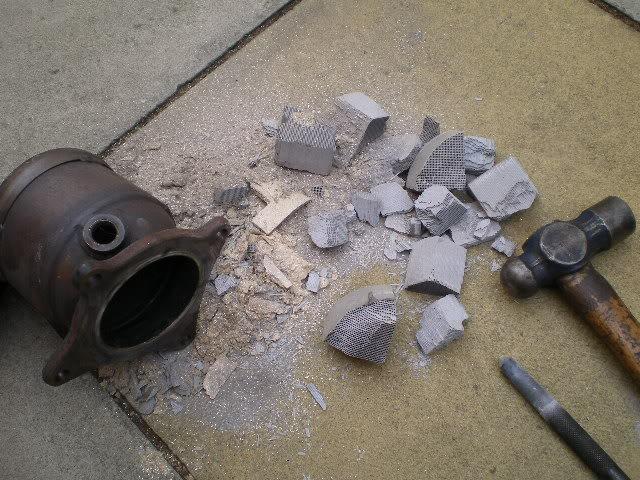

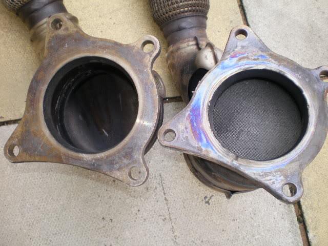

A couple more pics :

I'm really keen to do this when the weather warms up. One question though, are there any sensors i have to worry about that might not make it run smoothly??

Nope  :smiley:
The ECU adjusts to the extra flow of the exhaust and the cooler EGT's and all is well - as long as you don't damage the lambda sensor when removing the pre-cat

Can also confirm that this mod releases around 6bhp  :star: this was confirmed on the dyno

booked in at my mate's garage in a couple of weeks for a few bits - I shall have to see if we've got time to whip the downpipe off and remove the pre cat.
How long did it take to do? once the material is cracked/broken, does all it all kind of 'fall' out, or does it require extra work?

If you DIY this, just be careful of the O2 sensors directly after both the pre-cat and main catalyst, if you damage them they're not cheap!  My advice, remove the one nearest the turbo before you start...... :drinking:

It took my local garage an hour to do, not sure on how hard it is, just got to make sure you turn it upside down after and shake all the bits out.
I'd advise ordering a new gasket and nuts from vw first, only cost about £8 total.

Yeah I got 204 on JKM's dyno before then got 210bhp on R-Tech's dyno. I know it's not ideal to compare one reading on one dyno against another reading on another but it's there or there a bouts.
It cost me about an hours labour at my local garage (could cost more if your turbo bolts are tight).

Yes mate the K04 downpipe is exactly the same as the Ko3 (standard GTI) one. Would probably give slightly better gains on an ED30 too!

i know the cat will obviously slow down the gases but isnt the main restriction on the standard down pipe the bend?? it goes from 2.75 inch to about an inch within that bend. thats where i would say the big restriction is. hence why the aftermarket jobs have no precat and full 3" bend.
nice work im sure it sounds nicer and louder but to me this is like drilling the engine cover from the 80's and 90's just sound and no gains.
would love to be proven wrong (yes i have seen the 6bhp figure quoted but i can get that by farting in my car ;) )
