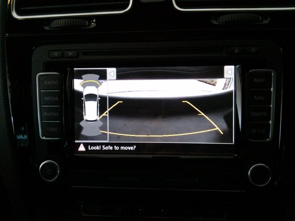

A bit annoyed though as when I got the car back, the Reverse Camera decided to be a pain in the ass and not work. The camera would still actuate and the image will still appear on the RNS510 unit but it seems the camera wont protrude all the way out?  This is all I see
Need to get this fixed...

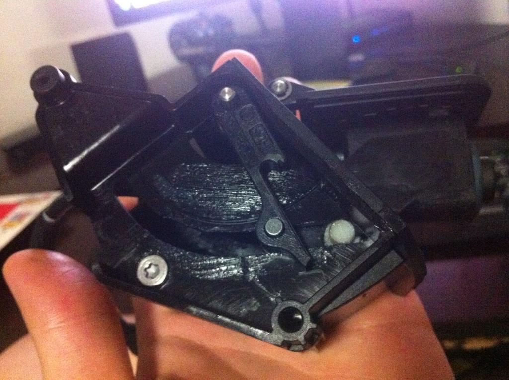

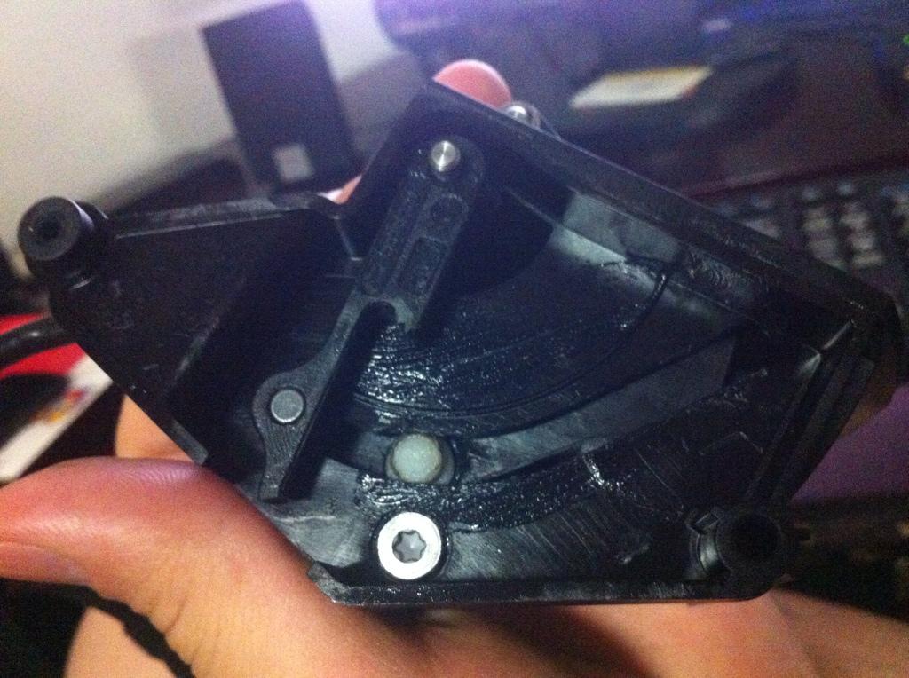

Also got the RVC issue sorted. I bought a replacement part quite cheap compared to retail (which I'm told costs something like $700.00 or something ridiculous from VW) and because I only needed the RVC camera and not the wiring that goes with it, I decided to give it a go myself and replace it.
Taking off the boot trim wasn't an issue as I had to do this before when I removed my rear wiper and put the wiper delete. The VW boot latch/RVC is held on by 3 T20 torx bolts. AFter you undo them, it's just simply a matter of twist to unlock and then pull out. Very easy. Since my RVC came from factory, I didn't have to mess about with wiring and it was a straight replacement, plug and play.
I decided to open up the old one to see what may have been causing the problem. It turns out that a plastic "latch" which is used to pop out the RVC had snapped off. The latch was hooked on to a metal piece which actuates and then protrudes the camera out, but being plastic, it's not unreasonable that it had snapped although I would have thought it would last longer than 2 years.
Here's a photo of the metal thing which actuates when put in Reverse
and heres the photo of the plastic latch which had broken. Photo with the camera fully out
Photo of camera retracted
Design flaw? Hmm, possibly, but these things happen I guess. I suppose I was just one of the unlucky ones.... Anyway, it's fixed and it all works again so I'm happy
