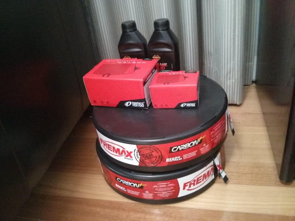

Front and rear rotors (OEM size. 345x30 front, 312x22 rear) and Remsa brake pads arrived along with some Penrite DOT 4 brake fluid.
Didnt want to opt for slotted rotors such as stoptechs or DBA's as I'll most likely be going 2pc slotted rotors anyway when i get my BBKs so these will do for now. Rotors are pretty much shot and are squealing more than a japanese porn video
Will be installing these soon but also going to have a chat with John from VSPORT to see how much slotting these rotors will cost. If its too expensive then i'll scrap the idea.

Rotors and Pads installed. No more squeals, no more tears! Love the new pads. Very minimal brake dust, same OEM bite and now with the rotors, the R is stopping very well!

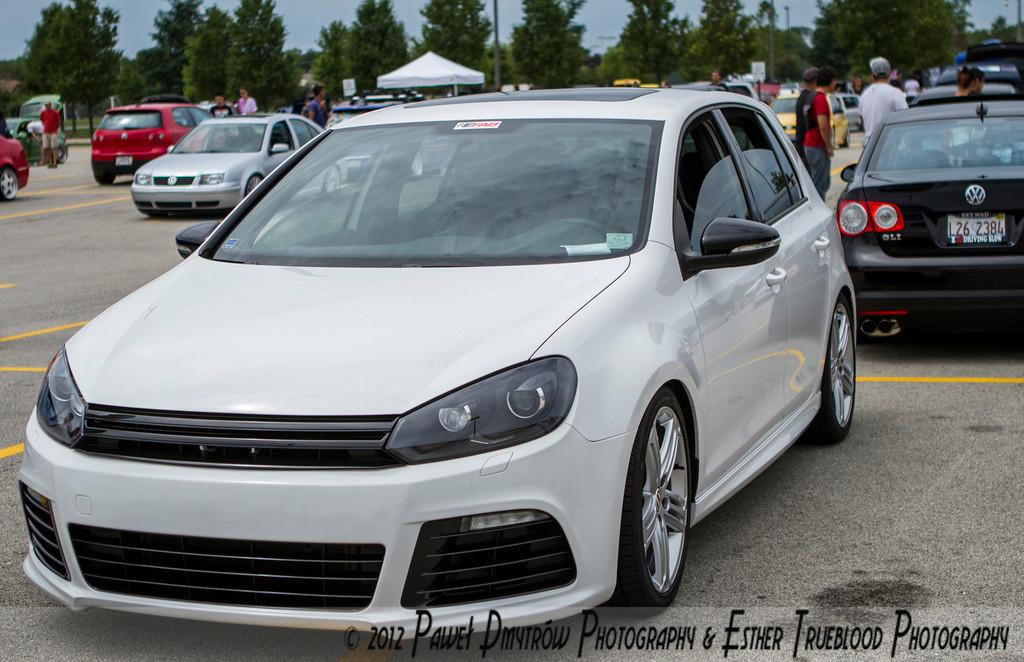

Heres a photo of it after it's had its 2 bucket wash

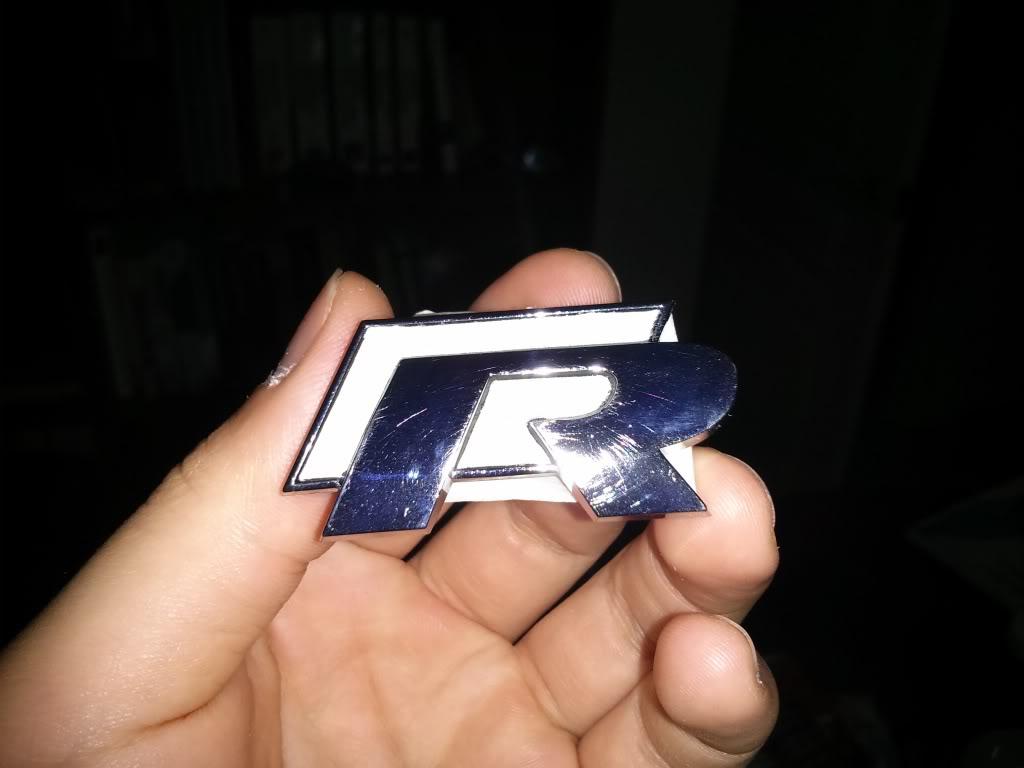

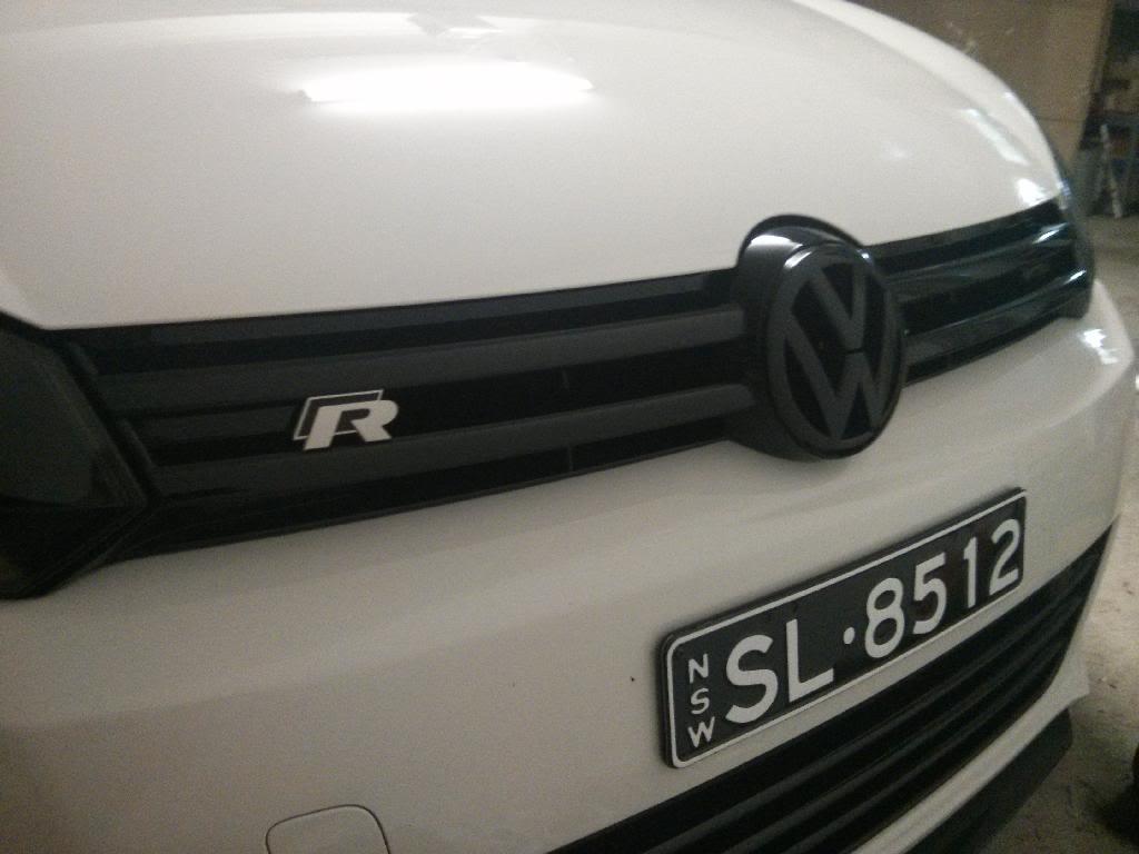

I also decided to do a little DIY. The Chrome "R" Badge on my grille always looked a tad out of place now that I have got rid of the chrome VW Badge front and rear as well as debadging the rear "R" logo too. So I decided to paint it candy white with the leftover can of Candy White spraypaint I had from VG autopaints a while ago. These guys can take any colour you have and give you a rattle can colour matched perfectly to your car.
I was going to keep the background of it black, but there is a very thin chrome border around the background square, which I was also wanting to paint. It required a little bit of patience masking up but in the end it got done.

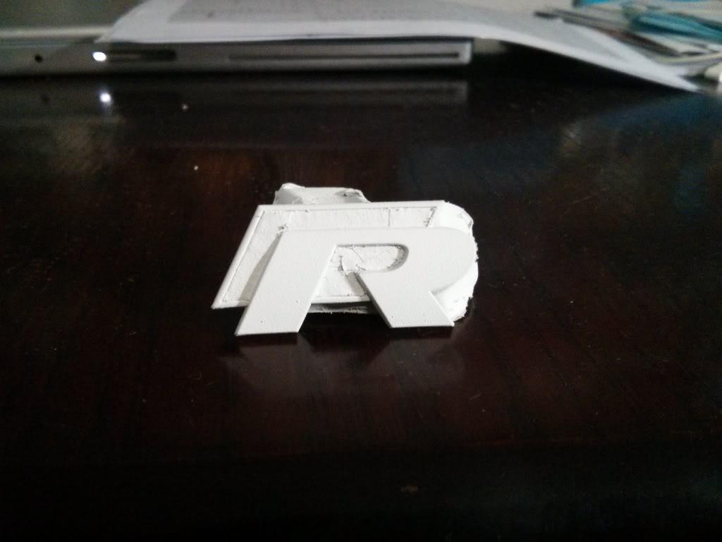

Masked up :
I sanded it down as much as I could as I needed to have the primer stick to it otherwise it would peel off overtime.
about 2x thin layers of primer and then I sanded off with 600 and 1500 grit sandpaper. Then, another 3x thin layers of candy white paint.

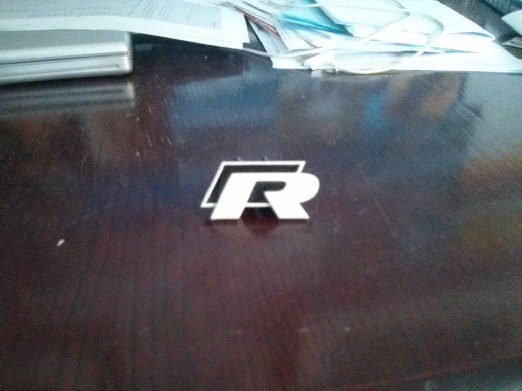

Result (apologies for the out of focus picture. Phone died) :
