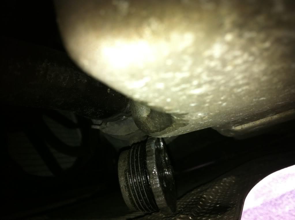

I was under my car the other day and noticed this part hanging down, couldn't see where it was meant to go but it is attached to something so id doesnt fly away, does anyone know where it goes or if it should be screwed in
any help is appreciated

It has a thread on it so should be screwed in somewhere for sure. Unless someone has wedged it in there to stop the heat shield rattling. It shouldn't be there for sure.

no its not there to hold the heat shield as it hangs above it
i thought it should be but not sure where it should be or what it does tbh

Looks like ( cant tell the scale) the cap that one removes from oil filter housing - you first remove oil from filter before actually spinning the filter off through a little sprung valve. This is the threaded cover for the oil filter valve which is held captive in a similar way to the petrol filler cap.

that would make sense, the car was in for a service two weeks ago

Lazy, lazy, lazy.  I would not be happy. I do my own oil changes for this reason. The cap is a precaution - it would be impossible for the valve to open itself but the cap is there for a reason and once the filter oil is drained the cap is meant to be replaced. The garage has the luxury of a ramp to make final checks and ensure everything undone is replaced and tightened; I lie on a foam pad with the car on axle stands yet check, check and check again is always my mantra. And I'm not on £65 per hour!

Jeez, sound like real professionals  :stupid: Anyway, just splice those wires together and tuck away and the light will go on. Probably best to use your eyes to judge pad wear anyway.
PS almost certain that cover simply screws in to the base of the oil filter unit. It covers a bleed nipple that is in there to allow oil to be drained out of it before removing the filter as has been said earlier.

so if i just connect them together, they dont need to be connected to the pad? i have 50% left on the front pads so im happy to judge them myself etc

Yup, just expose some wire, twist it together and secure with something. Chop them shorter to help keep things out the road if you wish.
The alternative is a new sensor loom but I really wouldn't bother until the pads need changed...and even then....
