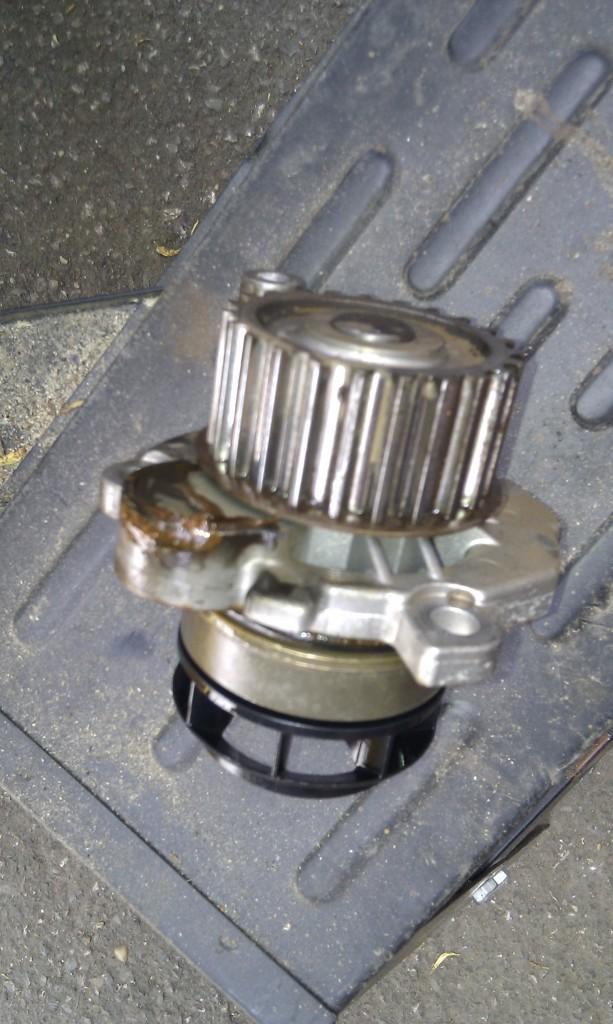

does the engine make any noises? it happened on my missus gt 170 bhp dsg the coolant was low up to the point that stop sign came up on the sign and the engine started making some strange noises, it turned out ot be water pump fecked and at 60000 km 2008 car totally unacceptable for me! that's the point where I stopped believing in today's cars built quality  :signLOL:

I had this problem on an A3 TDi which turned out to be a leaky radiator - common problem on A3s and MK5 Golfs - they leak at the bottom corners.
I also had a leak on a 2.0FSi Golf MK5 which turned out to be the water pump

« Reply #6 on: March 08, 2012, 07:05:08 pm »
I had minor coolant loss on my car from an untracable location. When I changed my cambelt and pump I found the coolant pump had a shaft leak.
I'm not saying it's your problem, just offering a possible.
By the way G12++ doesn't like to be mixed with other coolant - forms a horrible brown sludge!
