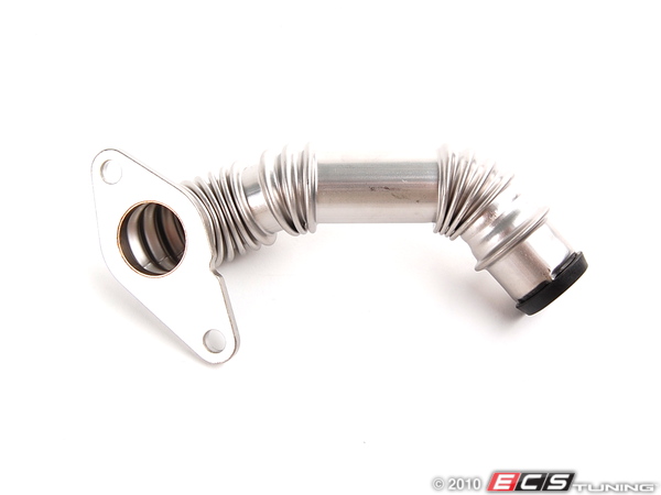

« Reply #2 on: March 05, 2012, 09:30:11 pm »
This is what the rear hose looks like.

Ah ha...
I replaced my PCV about a year or so ago and given I have an early 05 GTI its more than likely I don't have this doofer.  Where abouts is this pipe, does anyone have a P/N and what would the symptoms be of not having the extra check valve?

« Reply #4 on: March 05, 2012, 09:42:09 pm »
This link show you where the rear breather hose with check valve is located. With your original set up the breather hose didn't have the check valve.
http://oooo-a3.blogspot.com/2008/03/pcv-replacement-and-eurojet-valve.html
