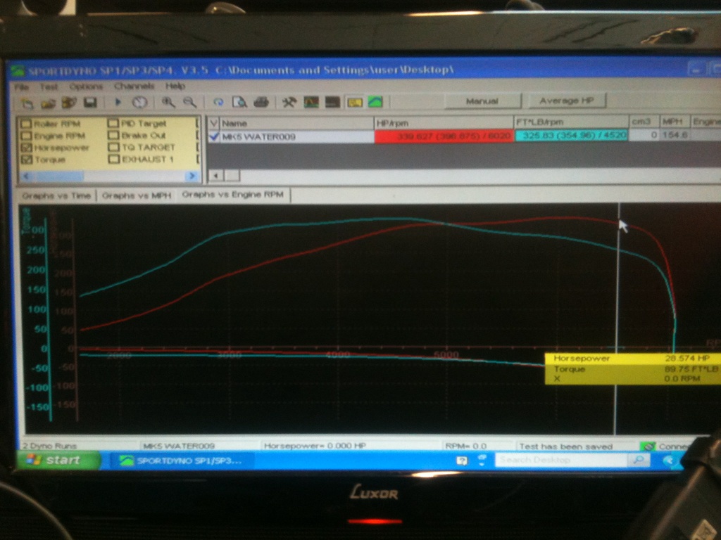

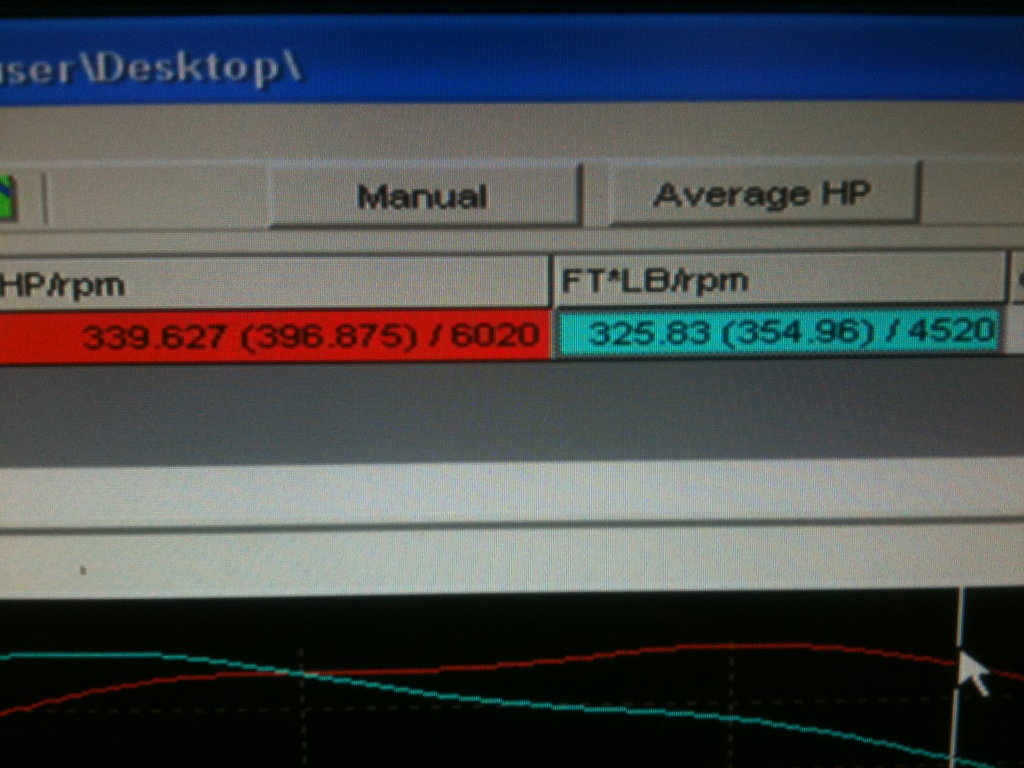

Well Nick spent most of the day on the old girl!  It has come to an end!  The final numbers are
There was problems with the car pumping out white smoke,  found it to be a problem with the forge catch can it is far too restrictive!!  so ordering a draft42 catch can!
Will collect it tomorrow!  Fab work by r-tech! :driver: :smiley:

How on earth dd you manage 397 BHP??  :jumping: What have you got on your car now?  :party:
just the stuff in the build  :happy2:
