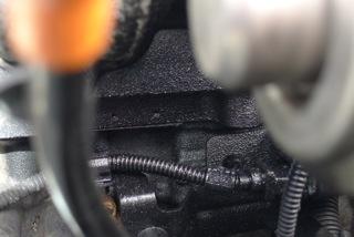

I've had my 2004 GT TDI 140 since November and have covered just over 7000 miles in it. It had a service and new Turbo fitted when i bought it. For the first few months i checked the oil regularly and it was always on max.
I checked it today and its now half way between max and min. There is no smoke as such and looking underneath the car no wet spots...However looking at the front of the engine underneath the plastic cover i can see a build up of oil?!

I've had a chance to take the cover off today and get some pictures
This is from looking at the engine from the front
This one is at the front again but looking from the side
Looking at the dipstick its now about halfway. So 7000 miles and using that isn't that bad. Its just seeing the oil patch is making me think it might be leaking abit too?!
Took it to a garage for a quick look and he said its not using too much and not to worry too much.
