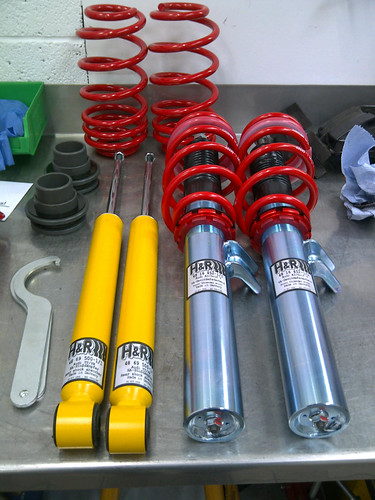

Bilsteins removed, replaced with H&R monotubes:
H&R Monotubes by lotus-gt, on Flickr

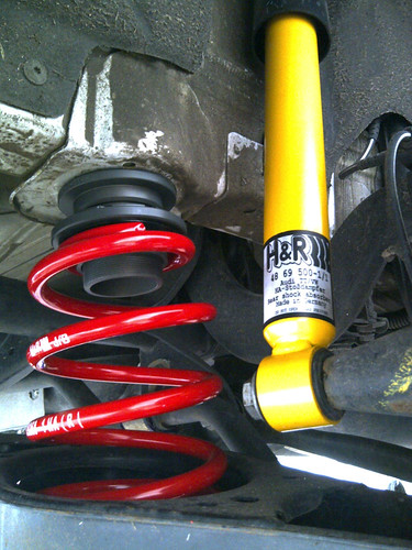

rears on:
H&R rear by lotus-gt, on Flickr

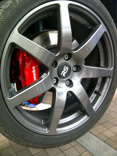

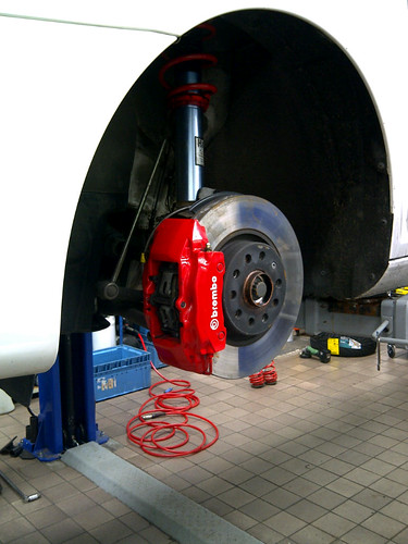

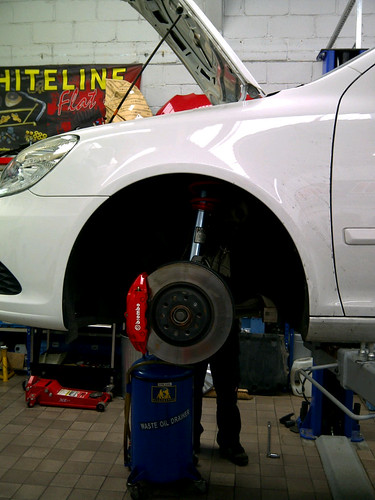

986 Brembos /nqsbbk i bought from Oli last month are now on the car:
Brembo by lotus-gt, on Flickr
.. and a pic including Alex's feet:
Brembo and H&R monotubes by lotus-gt, on Flickr

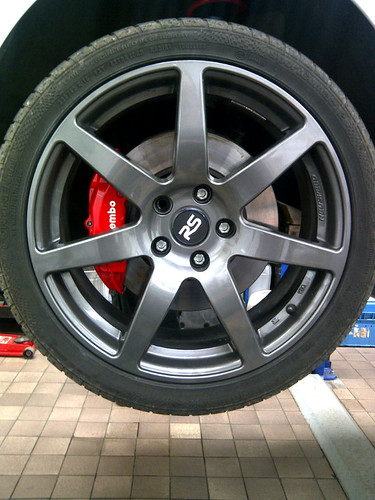

Refit the wheel, load of clearance:
IMG-20130405-00549.jpg by lotus-gt, on Flickr
IMG-20130405-00550.jpg by lotus-gt, on Flickr
And a pic taken a few minutes ago showing how it's sitting on the new bouncers:
First pic on H&R monotubes by lotus-gt, on Flickr
Ride on the H&R is very, very nice - better than stock I think.  Much better suited to what I need the car for - it's not a track day weapon for me, more a high mileage gt car.
