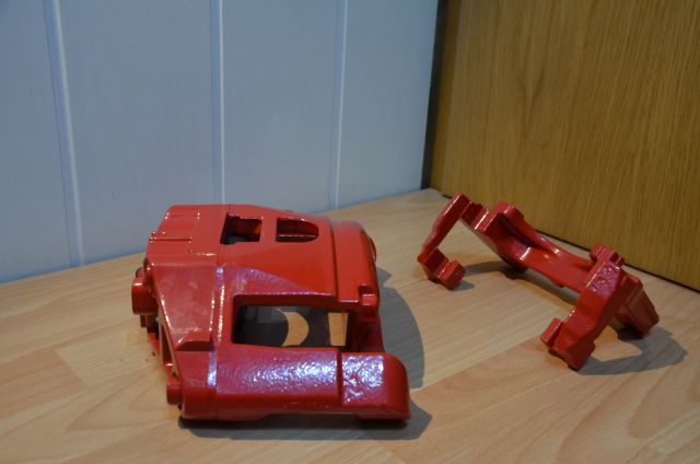

Sorry for using your post, but i have a small question?
Can someone tell me , is there a big difference between S3,r32,and audi v6 front brakes??
And can someone tell me , from which car are these brakes from??
Thanks
