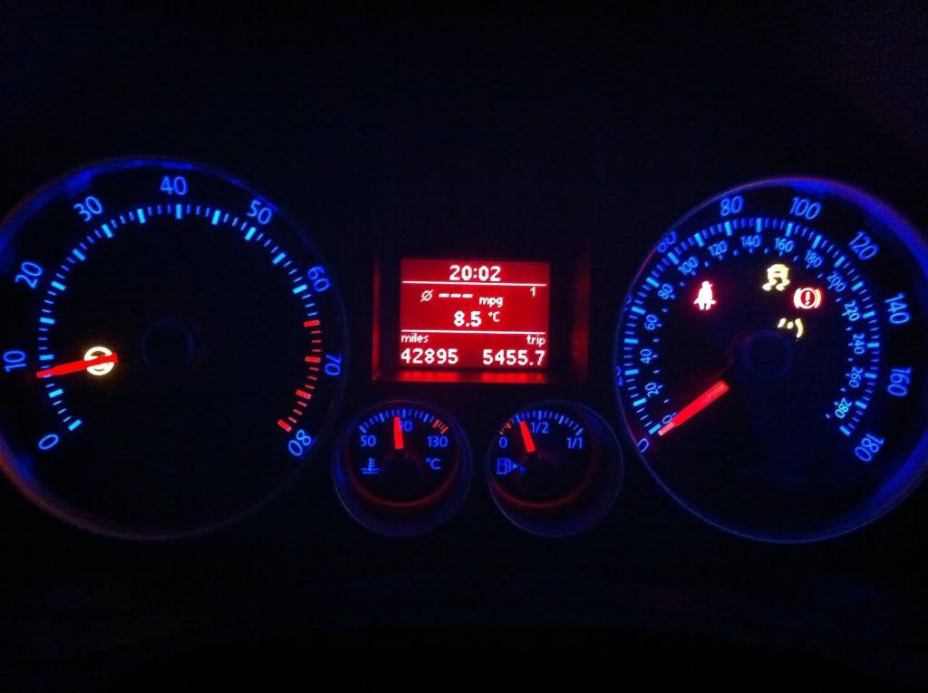

« Reply #7 on: April 03, 2012, 08:15:20 pm »
Because of the battery drain I have removed the rcd510 and put in the old rcd300. But when I started the car up again I now have the light on the dash below and can't turn the traction control off.
Does anyone now what iv done and how I can sort this?

« Reply #8 on: April 03, 2012, 08:16:12 pm »
take it for a short drive

« Reply #9 on: April 08, 2012, 04:18:05 pm »
Its approx 12 hrs for it too drain your your battery and as previously said take it for a drive or charge the battery and once you start it up again these warning lights should go out  :happy2:
