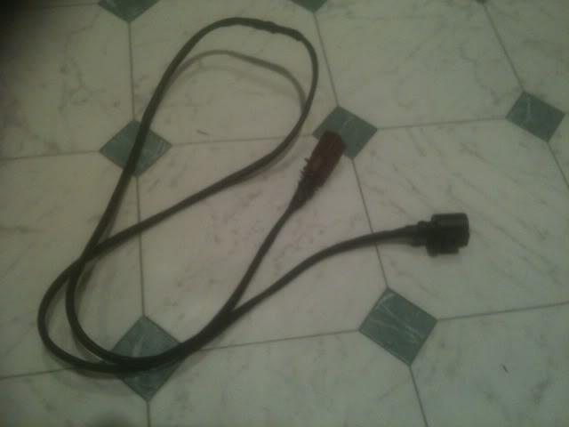

Did you get the custom wiring harness or just pull it through to the front? Did the relocation make any difference to the sound as to how the turbo spools up?

No DV relocation didn't make any difference to spool up sound. You can't pull the wires to the new location, it simply won't reach. I made my own harness

Parts from Audi not sure on VW
2x 000 979 134 A- wire
2x 000 979 133 A- wire
1x 1J0 973 722 A- connector
1x 1J0 973 822 A- connector
Take the pink and orange inners out of the connectors, plug in the wires and solder in the middle. You should end up with a 4ft length which I wrapped in heat shrink tubing.
