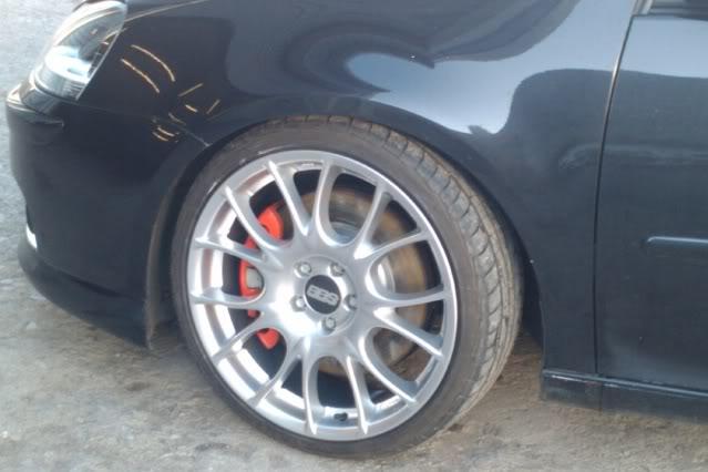

i just used red smooth hamerite,did them over a year ago

yeah just painted on,didn't want to get them powder coated and this way if they get stone chipped i just touch them up
