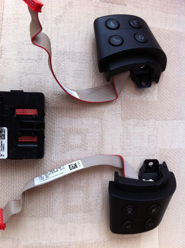

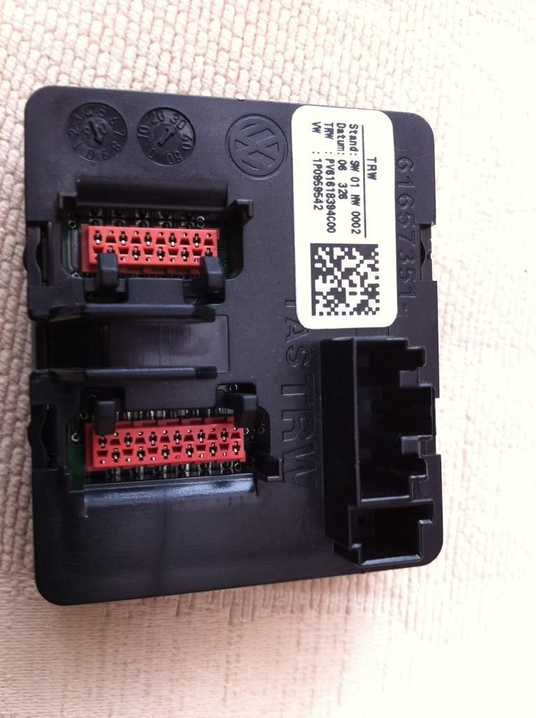

I have just bought some MF buttons and wanted to ask for some advice before I start,  My car is a 58 plate gti with paddle change. I get the jist on fitting the buttons but not sure what the box that came with them is for... will I already have this in the steering wheel as I have got the paddles or will I have to swap them and use the one that came with the buttons. couple of pics of what I have got but not had the airbag out yet. any advice would be appreciated.

When I fitted mine (on a 56 Plate) a box was already in the steering wheel. I left the original one in there and just plugged the buttons in. Everything work :happy2:ed perfectly. Easy peesy!

I did this to mine, if I were you I would swap over the the control box, just make sure that it is a later HW version.
Fitting guide I did here.  :happy2:
http://www.mk5golfgti.co.uk/forum/index.php/topic,18527.msg261976.html#msg261976

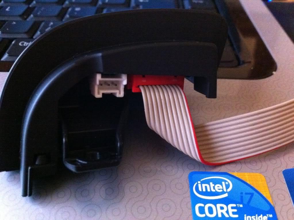

Ah right i think I am getting with it now... forgive me as i am getting on a bit  :laugh:
Looking at the differences It looks like I have the pre07 buttons, Just been out to the car and checked the colour the centre is probably slightly darker than the buttons but I can live with that as it is pretty close.
looking at the picture below I assume the paddles plug into the little white socket next to the ribbon plug... then the other end of the ribbon goes into the black box and that plugs into the car/ can-bus ... correct ?

« Reply #4 on: May 01, 2012, 06:50:42 pm »
Correct  :happy2:

Only other thing is do I use my box that is already there or the one that came with the buttons as mine is a late 2008 version and I think the buttons I have are pre 2007 but im not 100% sure .... if so mine should be more up to date than the box that came with them... or am I wrong ?
