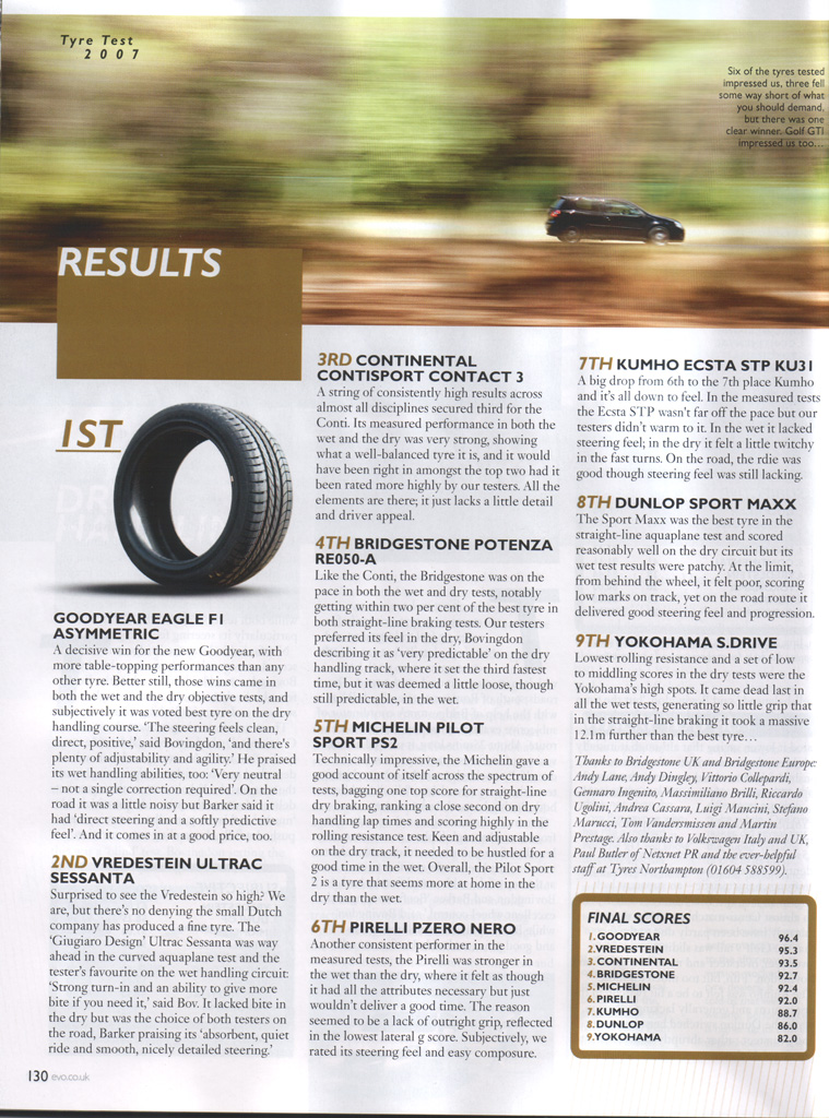

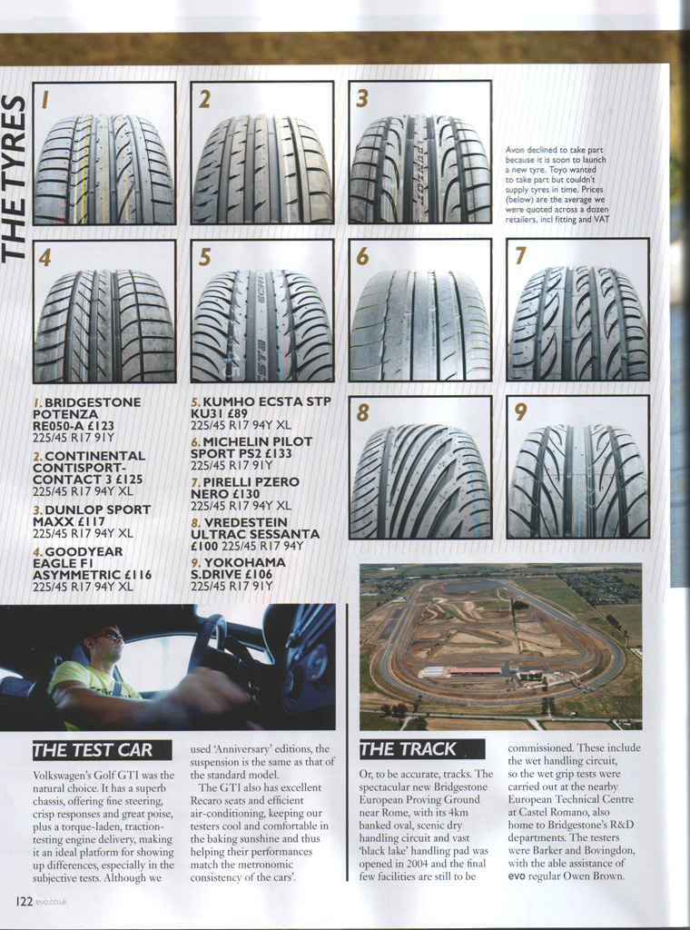

Id rank them as :
1. Goodyear F1 (based purely on the excellent review EVO gave them on their test)
2. Contis (these were excellent on mine... but sometimes the OEM fitted tyre is the best version of that tyre brand/model you ever get... and when you buy them again, they just don't feel the same.)
3. Bridgestones (I've found these to be good in the past, and they are great on my mate's GTI)

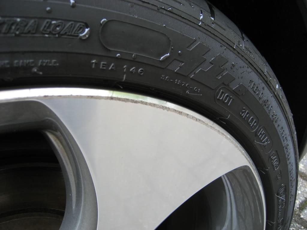

The originals Contis should have been 94Y XL .. They were on mine (2007 Model year).
You need XL tyres for a GTI and those Pilots from Costco have too low a load rating (prolly why they're cheap).
The pilots should be Michelin Pilot Sport 2 92Y Extra Load.
A la :
Extra Load Michelin Pilot Sport 2 in 225/40zr18 92Y on my slightly worn Monzas  :happy2:
