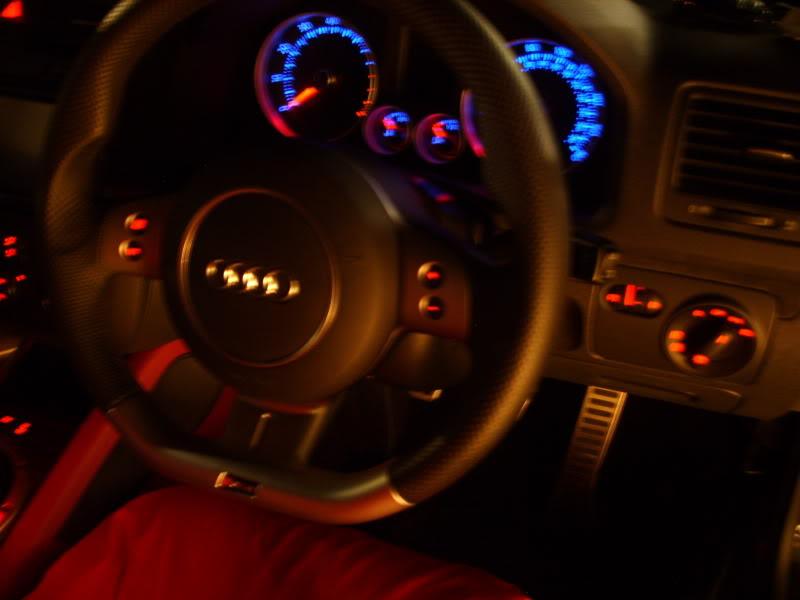

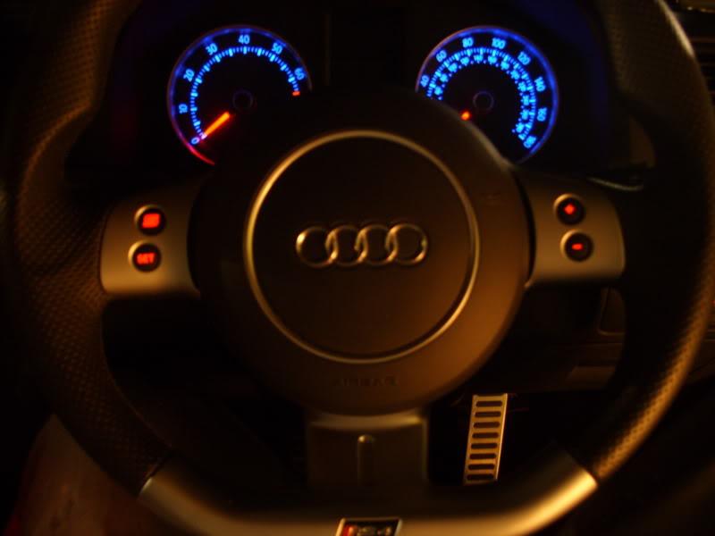

ok after another late night and practically 2days worth of nights the project is starting to turn UBER cool.
I've now intergrated my RS4 steering wheel with the car.
But intergrated into what i hear you say ha ha.
Here's a couple of pictures with the switches illuminated aswell to really take the mick ha ha.
Re: My Bagged mk 5 Gti build thread
« Reply #394 on: September 24, 2009, 11:15:24 pm »
 :notworthy: :notworthy: :notworthy:
« Reply #395 on: September 24, 2009, 11:15:36 pm »
So has some sort of custom wiring had to be done to get them illuminated? Do the buttons work?
Offline NEWEY
  • Posts: 1066
    • Flickr
« Reply #396 on: September 24, 2009, 11:19:55 pm »
 :notworthy: :popcornsoda:
TSR big turbo mk5 golf gti
Offline plush-automotive
  • Posts: 419
« Reply #397 on: September 25, 2009, 08:10:50 am »
Custom wiring isn't the half of it mate honestly anyone thats looked at the steeering column of one of these things will maybe understand, But yes all the buttons are fully functional. we set them up as the following.
the set button- i've wired to turn my set on (headunit) without the key in the igniton so i can deo the system easy enough as it's set up for the driver and i will be in the passeneger seat majority of the time for demo.
the S (sport button) we have set to ride height also working on a timed relay circuit that will pull my bolsters in on the seats like the rs4 (all electronic) which i've wired in to work of the seat buttons but not the steering wheel yet.
The + is airride up
The - is airride down i have also flushed a safety switch into the centre console so that when driving me or anyone else can push the - sign and the car won't go down, for safety reasons obviously. :smiley: :smiley:
Then obviously the lighting in the wheel comes on with illumination like the rest of the dash does.
