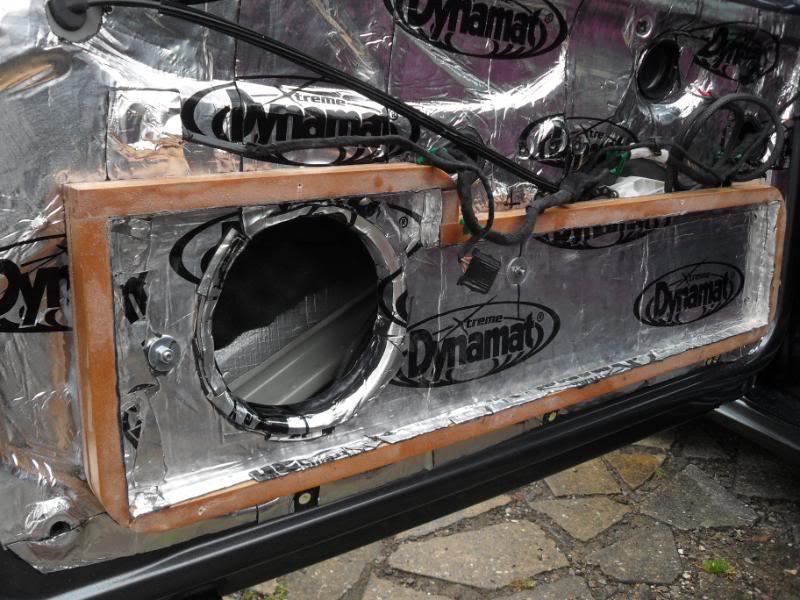

Here are a few more updates anyway it has only taken me a year to finally do the door builds :jumpmove: :jumpmove:
The midbass now is soo strong and puts a massive smile on your face with all the hours that have gone into this.
the speaker placement in a mk 5 is practically the only thing i hated about this car when buying it.
So we decided we needed to move the midbass to the front of the door where VW in the wizdom decided to move it to the bk of the door just for the mk 5 lol. they got it right in the mk 1,2,3,4,6 ha ha.
but rather than it just play flat againt the door we needed to build a sealed chamber that would port it back into the door also throught the factory speaker location.
start of the chamber with door fully soundproofed.
being as it has been working lates etc i've been a bit sketchy with the pictures but here you can see the front of the chamber complelty sealed and bolts solidly to the door. ( the door card mearly acts as a finishing peice).

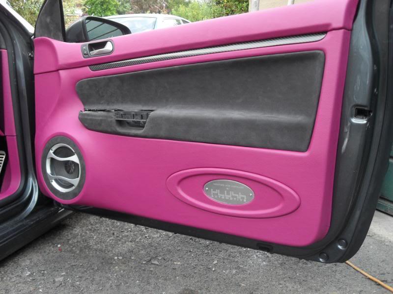

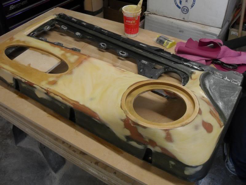

then a little work on the door card :laugh:
then trimmed and on the car only thing left to finish is the door handles which we have relcated the fuel flap switch into the drivers handle.

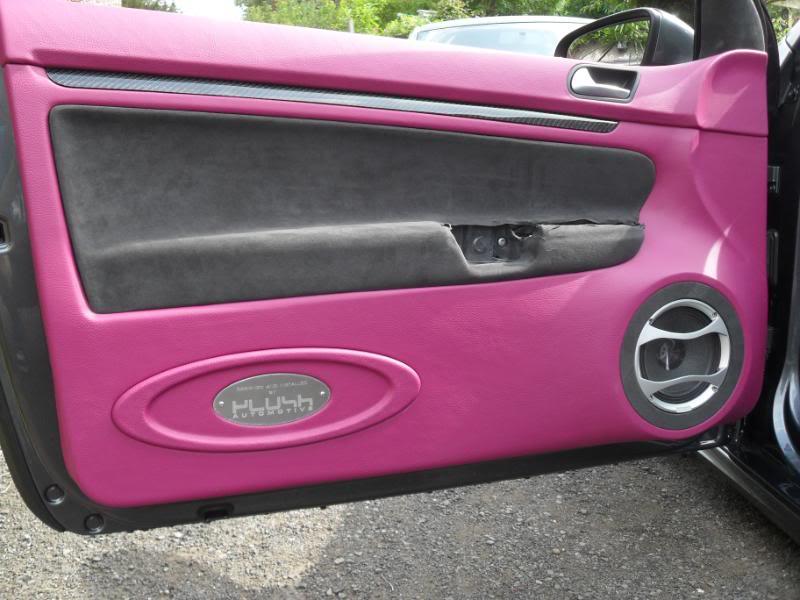

and the passeneger door. the other thing that bugged me is the fact the door cards arn't symetrical from the factory so i order an american one(left hand drive) and we fabricated that to fit on the passeneger door. Again we have the handle to plastic eld up with the usual extra controls and just leave the passenger window switch in there.
hope you like.
