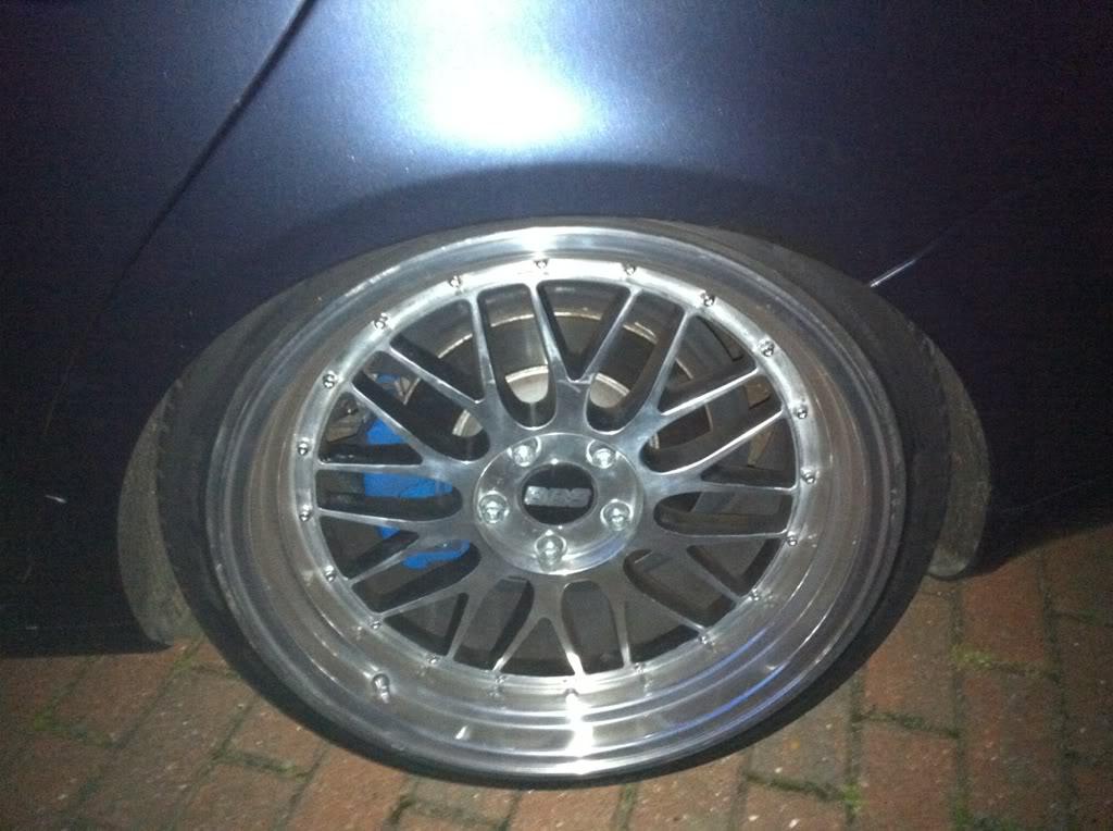

Hi all,
Considering refurbing the Mams I have and running them on my MK5.
Specs are 8.5 on the fronts ET45, 9.5 on the rears, ET 35, PCD 5x112. Current tyres on them are 235/35/19.
Would the wheels fit ok on the current tyres, or would I need to change them? I have 225/35/19s on my lm reps which I could swap over.
And would the rears poke?
Thanks,
Sharif

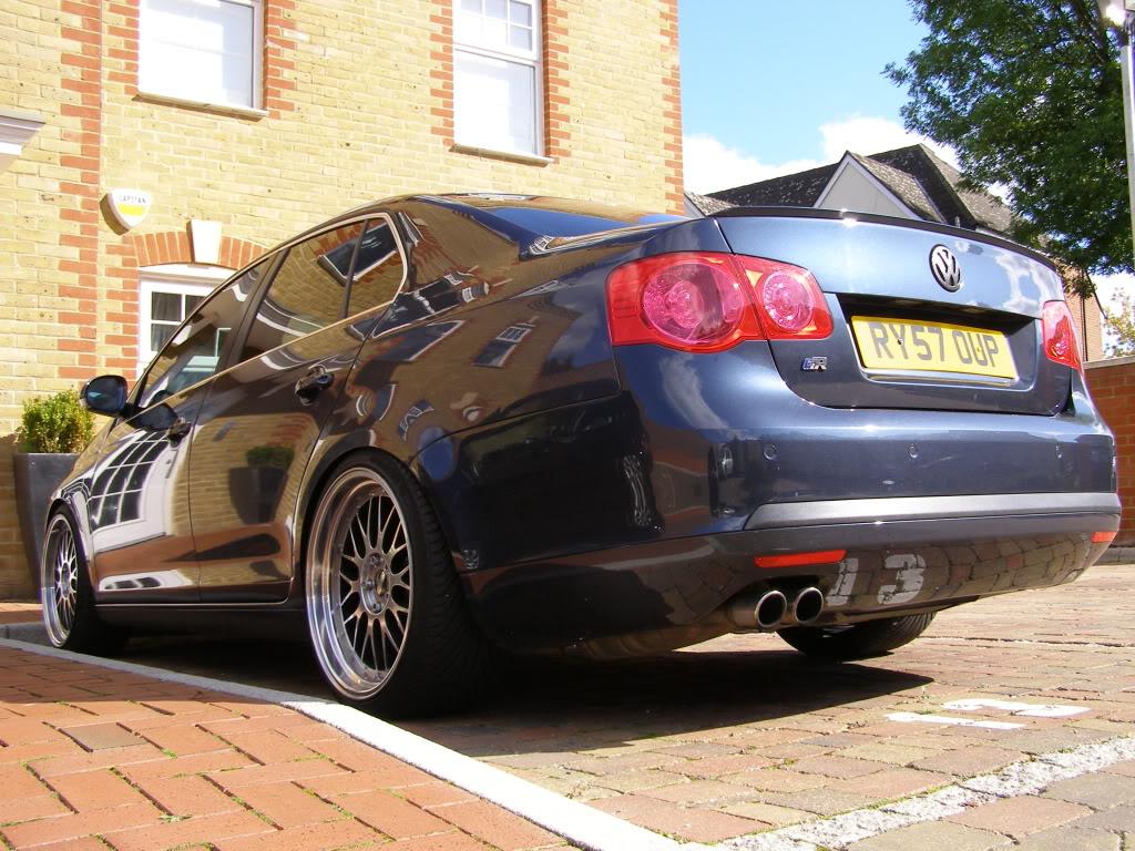

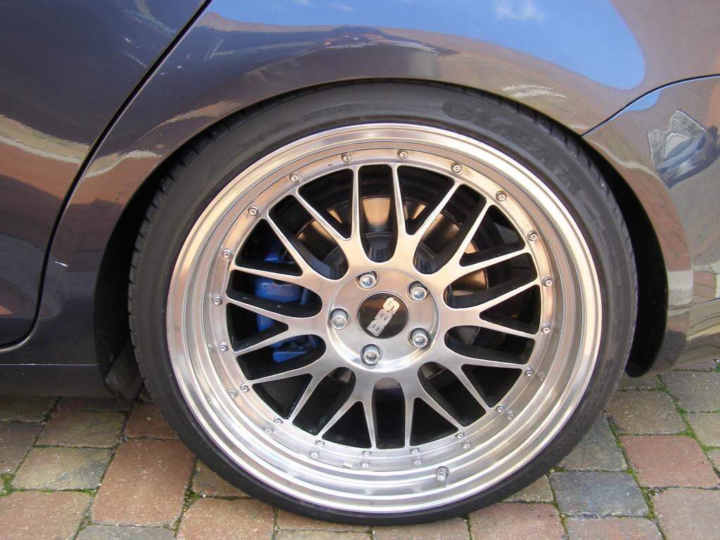

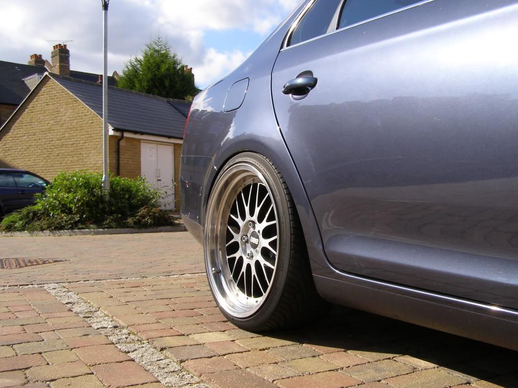

Sharif,
You would be ok up front slammed or not with ET45, rears : depending how low you wanted to go the rears will rub unless you  add the following,
option 1 dial in some camber
option 2 run 225's at the back for some added stretch.
Or both of the above will work really well.
Here is mine with 19x8.5 19x9.5 ET35 all round 215/35/19 up front 235/35/19 rears, did rub at the back causing some damage on the arches as well but I was not running any camber at the time.
