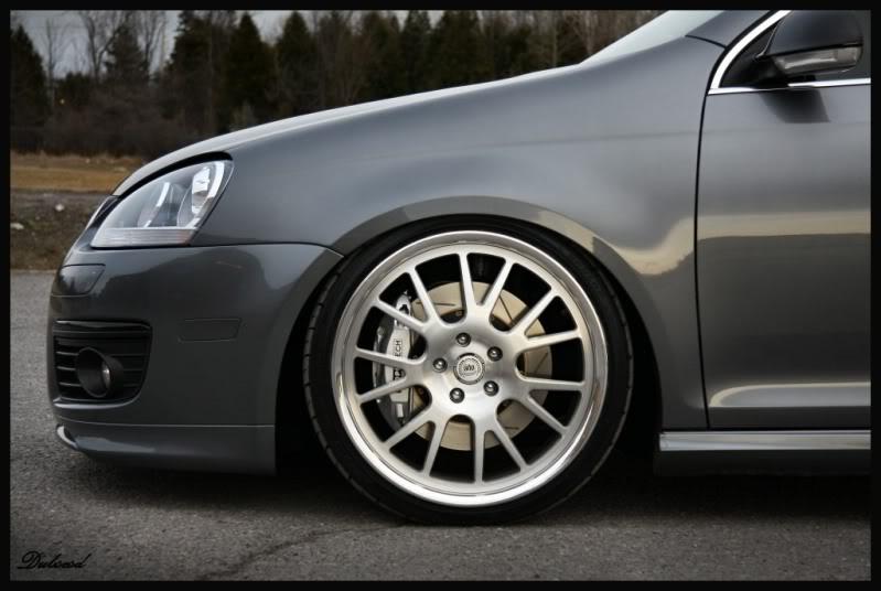

These look pretty tasty!! Not sure how they would perform though..
http://www.golfmk5.com/forums/showthread.php?t=77954
In terms of what you should buy..
VW Racing for sure.. They are fantastic! Should have mine on last this week fingers crossed!!

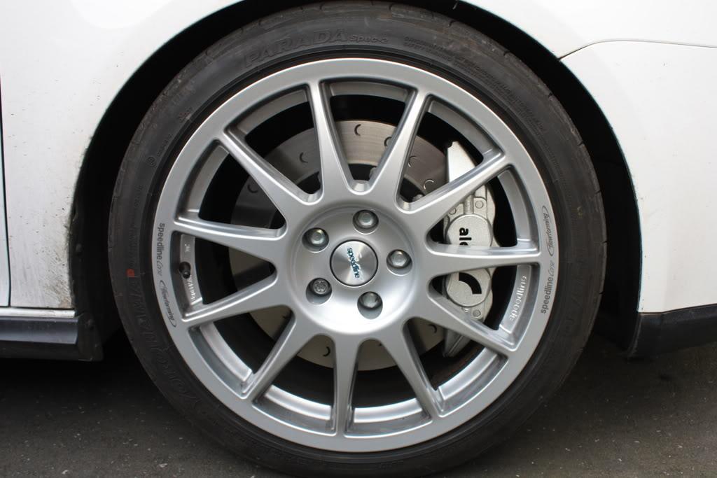

My Alcons below 343mm 4 pot, there's also a 360mm 6-pot kit listed for the TT that fits.
AP Racing do a 360mm 6-pot kit too from the 'Rocco, in the region of £2.5k

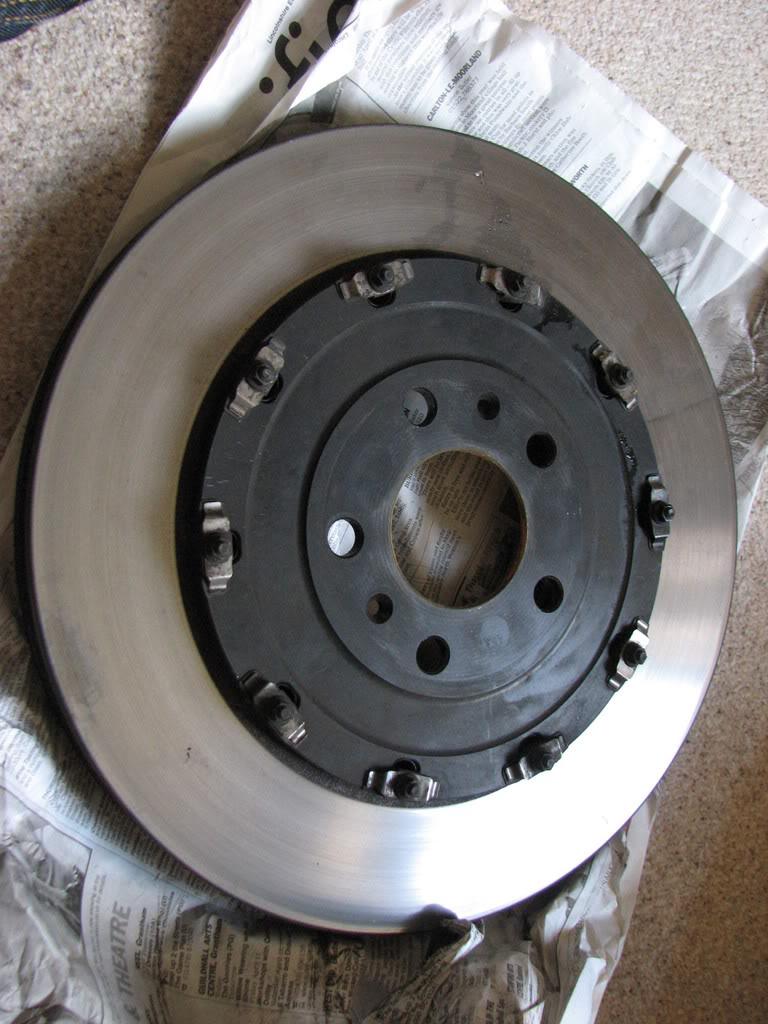

So what are the differences between this and their junior brembo kit.   :signIWS:
off the top of my head :
the GT kit's have smaller pistons, so less clamping pressure when being used spiritedly
the GT kit will be alot heavier - so unsprung weight is great effected
the GT kit's rotors are one piece disc's - the more expensive kit are semi floating.
the more £££ kit just looks cooler - but if i had it i'd go for different disc's, slotted or plain not drilled as i cracked 3 sets of AP330 mm drilled disc's on my Evo 6 - not the biggest fan of drilled.
If i could i'dupgrade to the fully floating desgin as found on the B7 RS4 but used the Phaeton plain disc (as i did on my B6 S4)
Not the best picture, but you can just see the floating spring shims, worked very well, esp with the 8pot brembo's - 3 trackdays at Castle Combe and sprited driving aplenty with out warping
HIH
