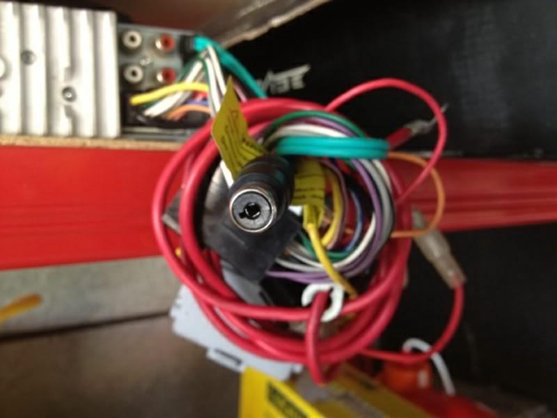

People this is the pic of the aerial on the back of the unit:
Hope this helps

« Reply #4 on: July 31, 2012, 10:43:17 am »
Youll need a FAKRA to ISO
Like this

« Reply #5 on: July 31, 2012, 05:44:28 pm »
Like this
So basically this one would be the wiring harness for me then:
http://www.caraudiodirect.co.uk/con-ct20vw03-ct20vw03-harness-adapter-vw-passatgolf.html
Still have to get the facia adapter of course lol
